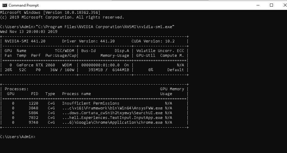

I tested gpu acceleration, but it does not work. situtation is below.
*** FATAL ***
An error has occurred when trying to check for any GPU devices on machine .... Error code = 35 which translates to: CUDA driver version is insufficient for CUDA runtime version.
Please check your GPU device driver level and verify that a supported GPU device has been installed correctly.
GPU Acceleration: NVIDIA Library Requested but not Enabled
GPU Device with ID = 0 is:
GPU Driver Version: 9.10
Environment is below.
OS Platform: windows 10 64 bit
Video Adapter:
1. Intel(R) UHD Graphics 630 (i disabled this device)
2. NVIDIA Tesla C2050
cuda runtime version and driver version are the same 9.1 by deviceQuery.
cuda: 9.1.85_win 10, nvidia driver: 390.85-tesla-desktop-win10-64bit-international
ANSYS product 2019R3 workbench
I set ANS_OVERRIDE=1, and cuda driver set to TCC mode.
but error has not gone, please let me overcome this error. thanks.
