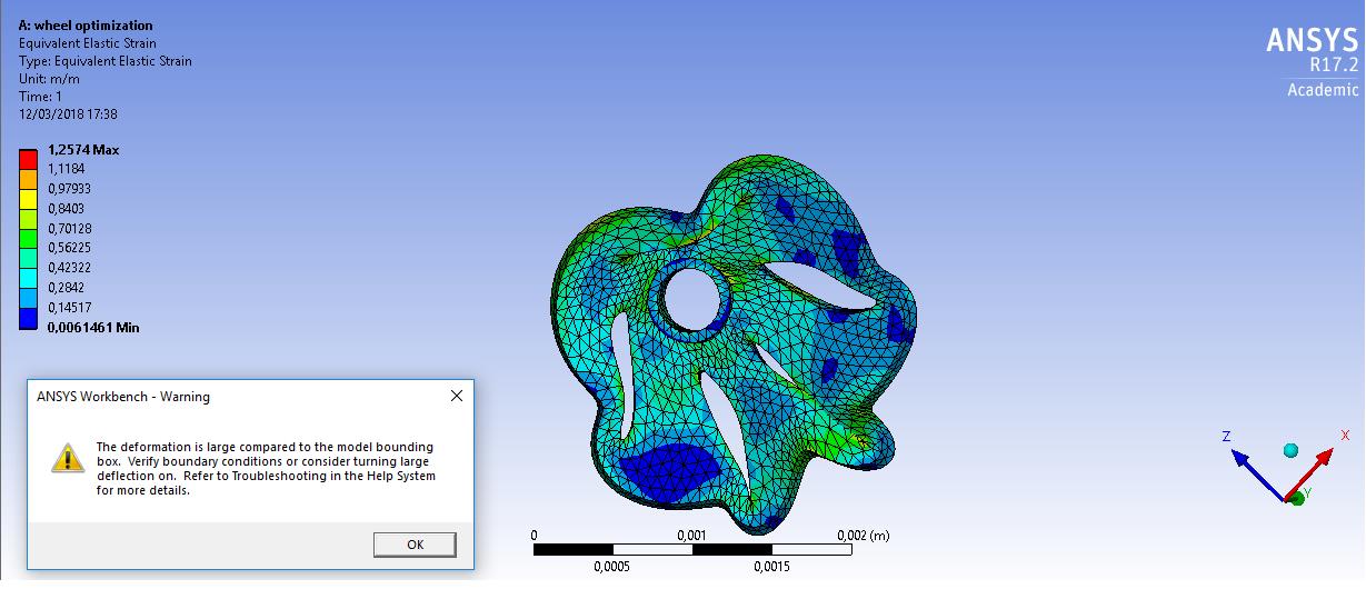

    Oh yes Peter, very good! So, I need join the ground in the CAD Model. How could I carry out this simulation of impact analysis? From the way I set up the loads I got what's in the image above and I got the following message. Now, Peter, how could I improve my geometry? Making one with 6 holes for example and comparing the results? Or lessening the thickness I used? Or even doing other types of holes? I would need to lower the weight of this wheel without lose resistance, in my opinion it is oversized. I get a crazy result! hahahaha. I get this mensage, I do not know if it's because of the wrong way of defining the loads or the size of the geometry. The diameter of the wheel is 80mm, the holes have 17.4mm of diameter and the middle hole 16.3mm of diameter. And I need respect the diameter of wheel and diameter of middle hole. How can I make an wear analysis on the tread and the bearing surface?

    That's a funny looking deformation.  I attached my model above in an ANSYS 17.2 archive if you want to open that.
    There are two approaches to Shape Optimization José.
    One is you have a small number of parameters, such as the number of holes, hole diameter and wheel thickness. You set up DesignModeler to have Parameters that can be used in Mechanical to study those parameters.
    The other approach is to have no holes and let Topology Optimization take away material that is not needed to support the load. You will end up with organic shapes that are easy to print in a 3D printer, but not easy to turn on a lathe and drill press.
    I recommend you try the first approach first.  What is the range of hole diameters you want to try?  What is the range for hole count you want? You might have to limit the hole diameter range when the hole count gets high or you will end up with no spokes.
