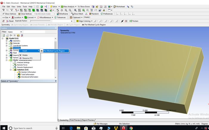

    I edited the geometry to cut the modal in half for both face sheets and core.
    But in mechanical i cant find the symmetry region.
    edited October 2019
    Reread my post above, "In Mechanical, right click on Model and Insert Symmetry."
  • PrashankPrashank Member
    edited October 2019
    Yes I did it.
    I right click on the model , inserted the symmetry folder and then I when I right clicked on the symmetry folder I have only one option i.e pre meshed cyclic region.
    ( Screenshot in the previous post)
    edited October 2019
    I see now.  I don't use ACP-Pre so I don't know how Symmetry works there. Maybe it doesn't work in an ACP-Pre model.

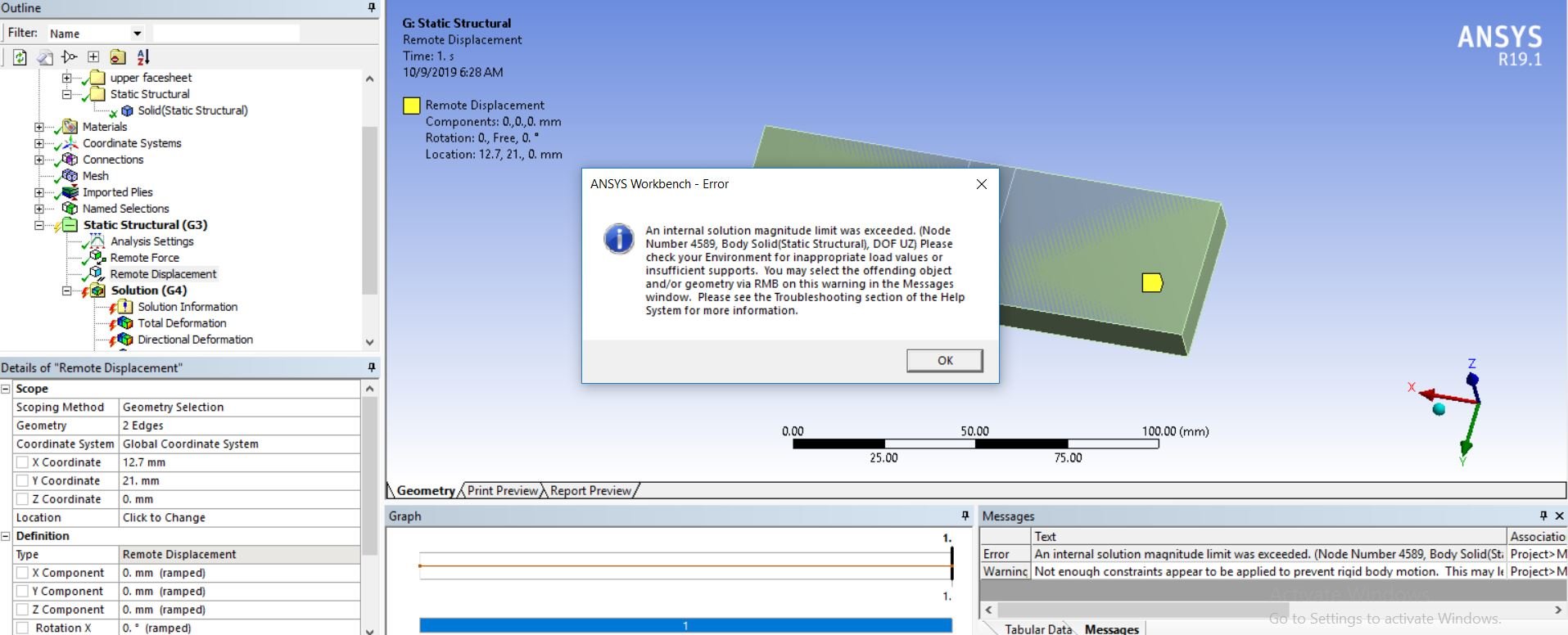

    Hi peter
     i increased my mesh element size. Then i got the following error. This error point towards the core.
    i set the remote displacement condition with 0,0,0 in translation and 0,free,0 in rotation.
    edited October 2019
    You must use two Remote Displacements, one for each roller support. Delete the one you have because on creation, it sets its coordinate system based on the edge selected.
