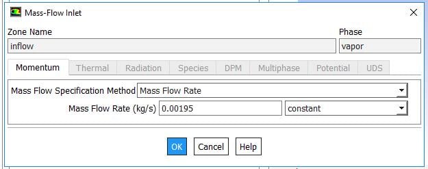

    i did simulation with all three methods (VOF, Mixture & Eulerian) and in all cases, I put "Mass Flow Inlet" as inlet boundary condition, so base on the vapor quality, an individual mass flow for each phase has set for.
