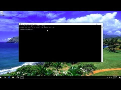

    Hi, I could fix the problems using the same steps
    For the first part you can watch this video:
    Inside the prompt you will insert the commands:
    regsvr32.exe ole32.dll
    regsvr32.exe atl.dll
    regsvr32.exe oleaut32.dll
    regsvr32.exe scrrun.dll
    regsvr32.exe jscript.dll
    regsvr32.exe vbscript.dll
    And after this step you should go to Disk C:-> Users-> The folder with your name -> AppData -> Roaming -> Ansys. So you can rename the folder with your license (mine for example is v201) for "(Your License)_old" (mine for example v201_old).
    I hope it works
