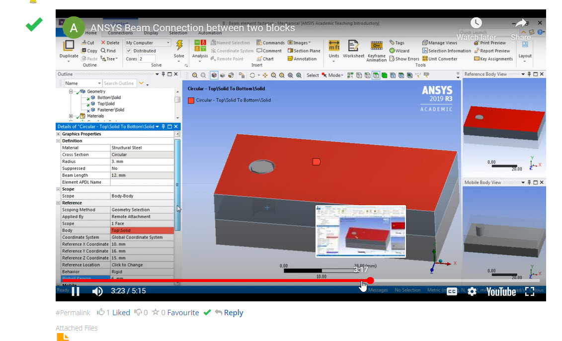

    Here is a followup video showing how to do a beam connection. This takes a little less effort than the solid fastener shown above.  The attached file is from ANSYS 2019 R3.
    edited April 28

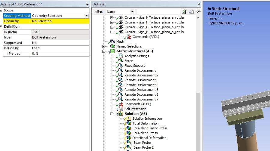

  • Rebeca1305Rebeca1305 Member
    edited May 17
    Dear peteroznewman,
    here you are, I have the option to insert BOLT PRETENSION in static structural but it does not display nothing on named selection.

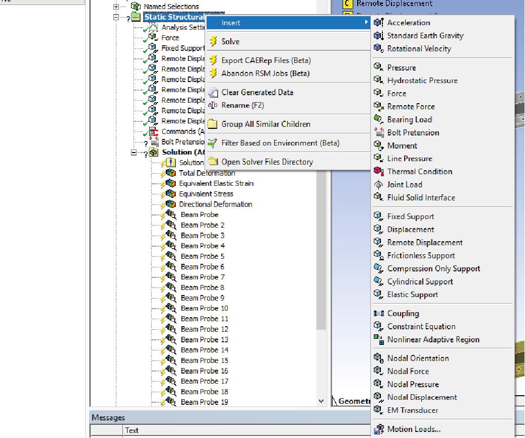

    edited May 17
    Dear peteroznewman,
    here you are, these are the load available on ansysV16; I have been investigated how can i put this pretesnion on beam elements and the answer was using APDL comands but i haven´t found wich of them I must use.
    thanks for you answer.
    edited May 17
    Insert a Bolt Pretension, then pick a line body that is meshed with beam elements. What is stopping you from doing that?
    The only requirement is that the line body must have a minimum of 2 elements along the length. If there is only 1 element, it will fail.

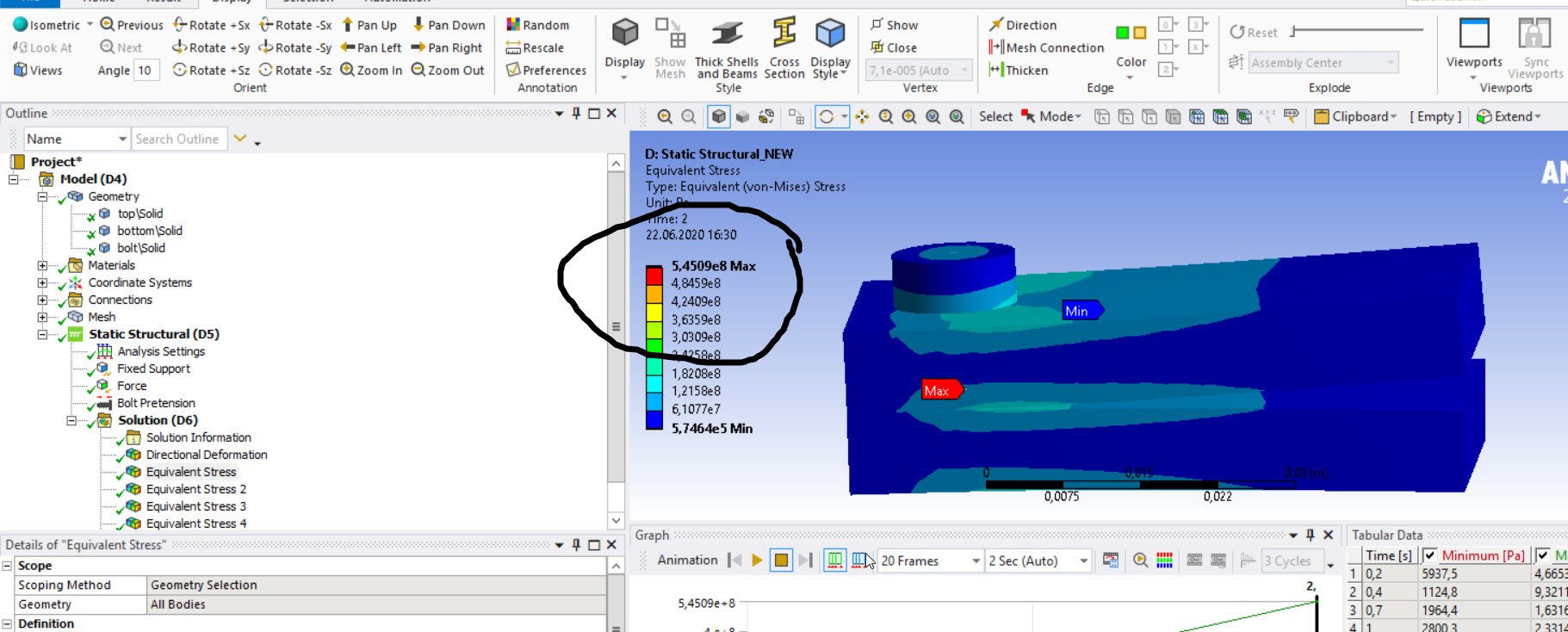

    Hi Peter, maybe one day you will have time to look at this question,
    I have tried to run the model for your first analysis, it is ok, except for the von mises equivalent stress, which is higher than in you video, what do you think can be the reason for it? Thank you in advance!
    edited June 22
    The reason for the difference in the initial result is that we were using different versions of software and the meshing parameters changed slightly to give a different mesh.
    I got 469 MPa in the bolt, you got 545 MPa, but that was just an initial mesh. If you and I both did a mesh refinement study in the different versions of software, we might get closer to the same number, or discover that this model contains a stress singularity where the bonded contact holds the threaded end of the fastener in the hole.

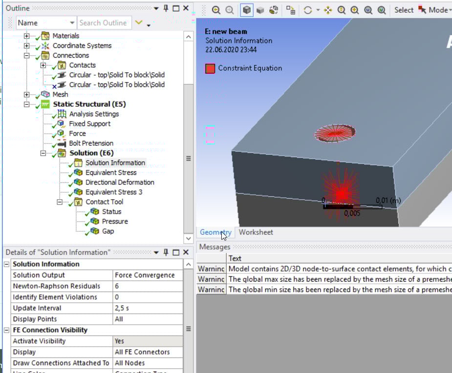

    Hi Peter, I have tried this one as well, I can not succeed with having the bolt head connection equal to 12 mm.
    please see foto, do you know what can be an issue?
    Thanks

    No, I have not used ACP.  I expect bolt pretension can be used in ACP Pre but I have never used that myself.
    It looks like you did not specify a Pinball Radius of 6 mm for the Beam connection.

    Hi Peter, I have tired with pinball radius, it doesn't work. Could you please tell maybe I  must choose a surface not an edge. Please see screenshots, I have tried several times and sorry to disturb.thank you
  • kaitovakaitova Member
    edited July 10
    Hi, this issue was solved, I just needed to turn around the surfaces on which I applied connections for the beam. Thank you
