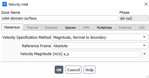

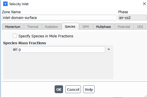

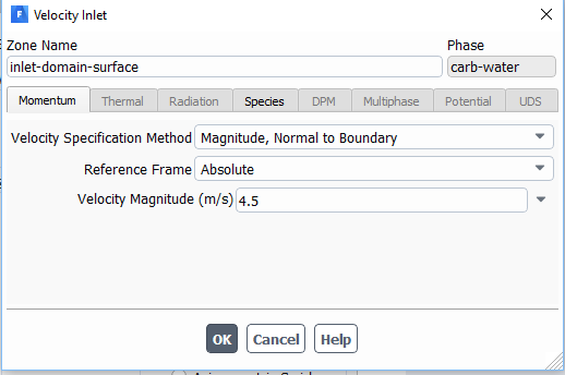

    1. my inlet conditions are...
    inlet: top surface:
    " alt="">carb water = mixture of CO2 + Water
    And also... as an initial seeding...
    " alt="">mixture of Air + CO2
    " alt="">Since I only want co2 interaction...air mass frac = 0
  • DrAmineDrAmine GermanyForum Coordinator
    edited January 27
    Both Co2 components need to be solved via transport equations.
