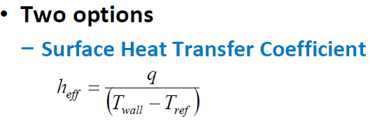

Could you please slightly elaborate, perhaps by giving a hypothetical example yourself, on how is the reference temperature to be given for nusselt calculations, lets say if I have a constant heat flux wall bc, instead of the T_wall bc specified in the above pdf.
As h_eff = q/ (T_wall - T_ref), and following the instructions of aforementioned pdf, I had set my reference temperature equal to bulk temperature at periodic bc, however this just gave a nusselt value (area-weighted average-on wall), twice of what I sould get from an emperical sieder-tate equation for a smooth pipe.

    So, the pdf mentions the following two formulas
    " alt="" width="308" height="96"> and image" alt="" width="160" height="102">, and later mentions image" alt="" width="387" height="68">
    So the point i am trying to make is, Nu will change, as per any T_ref value that I might enter.
    So how can I know which value to enter?
    Or what method can I perform (even manually) to come to this value.
    And if the pdf is to be followed, setting the inlet temperature for periodic bc same as the reference temperature, does not seem to give me a correct Nusselt, or even nearby nusselt to an emperical relation. It is possible that, then I must find the emperical relation that is more close to the nusselt that I have obtained, but I wanted to know if there is a way for the other way around.
