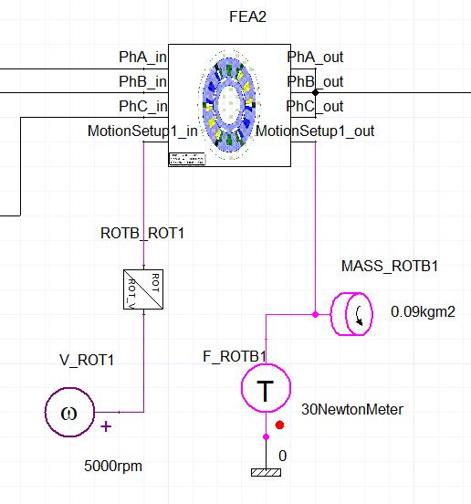

I have been analyzing a co-simulation setup, which has a motor imported from Maxwell 2D into Simplorer. The motor is a four phase one, but imported version shows five terminals, all of them having in and out pins. I am confused with pair of terminals for motion setup. I have few questions on this,
1. What are those pair of terminals named as motion setup1, shown in image.
2. If it is for mechanical load setup! May I know how to connect them without resulting in error.
3. It is taking too much time to run the model When incoming end is grounded and outgoing end is loaded. Is there a way to speed up the simulation?

    Yes, I came to know one has to be connected to set speed and the other terminal has to be for the mechanical load. The mechanical load might include torque "F_ROTB" and mass "MASS_ROTB" and speed "V_ROT". If you reverse the speed and mechanical load connections motor will rotate in the opposite direction.
    However, the induced voltages across windings are not balanced and showing DC offset as well, the torque also fluctuating and average torque is showing as zero.
    Note:
    I have excited the imported model from maxwell with AC current sources to see it's functioning and then will proceed to build controller.
    The maxwell design or FEA of machine has shown promising results but things have changed when I imported into simplorer with external excitation.
    I really appreciate if anyone can suggest inputs on the same!

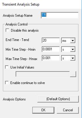

    Did you encounter any problem like this  "[Sim2000] Error - FEA1: ERROR - could not find a transient operating point before launching Maxwell >> Calculate at t=0.0005" when doing your cosimulation?
    I did try changing the time steps.The required time step was very small which took ages to solve. Do you have any idea about this one?

    I got the similar error. I tried different time settings. External Circuit Simulation TimeMotor Simulation Time

    Try stop time as 0.0015 and time step as 3.75e-05
  • GayaniDeSGayaniDeS Member
    edited March 10
    I tried that value. Still the error is same.
