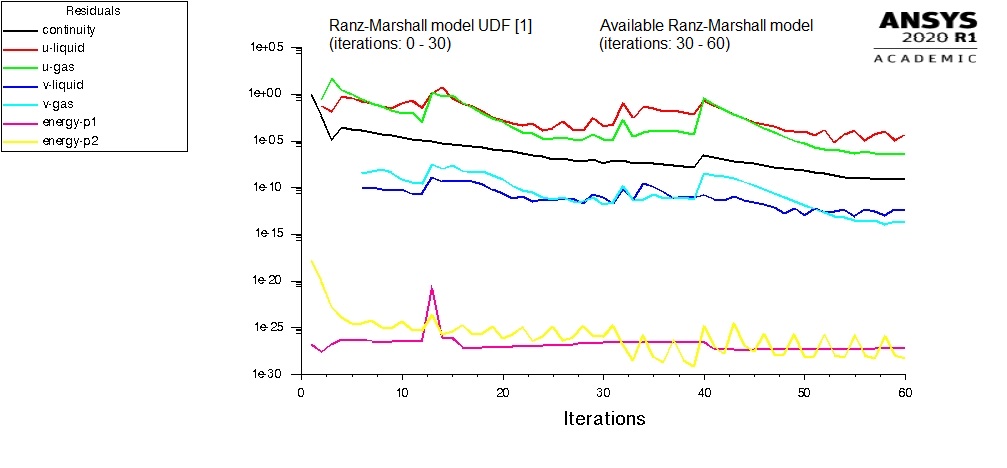

my goal is to model interphase heat transfer inside "Two-Resistance" model using user-defined volumetric heat transfer coefficient (HTC) at "To-Phase" in Eulerian Multiphase solver implemented in academic version of ANSYS Fluent 2019 R3.
Incorporation of user-defined volumetric HTC results in solution of only the energy equations, as shown in the attached figure. Here, the code for "Ranz-Marshall" model available in [1, p. 172] is used.
However, if "Ranz-Marshall" model already available in the software is used, all the conservation equations are being solved, as denoted in the figure.
The question is: "What is missing and causing solution of only energy equations?"

    Alright: Your UDF returns the HTC times area density. That is correct but you need to change that beginning with 2020R1. But you need to be careful here: If you are using another kind of inter-facial area it should be reflected in the HTC using the same formula.
    We changed that in 2020R1 so that beginning with that release you just need to return HTC.
    We have not seen the issue in R3 so that I cannot tell you what is the reason behind that. I am pretty sure that the behavior is correct in 2020R1 ( I ran a project on that).
    Is there another say exotic setting you are using in your setup? If not: Can you please start from mesh and re-setup the case? If possible also  try with 2020R1 and let me know!

    All the conservation equations are present in solution process when interphase heat transfer is modeled using UDF [1] in ANSYS Fluent 2020R1, as shown in the attached figure.
    However, it was necessary to keep multiplication of heat transfer coefficient with the interfacial area. Here, the interfacial area is calculated using particle model (6. * vof_g / d_g), while "ia-gradient" is selected in "Interfacial Area" tab. As I have understood from your advice, the expression for interfacial area should be the same in UDF and in "Interfacial Area" tab among "Phase Interaction" modeling options. Although it was not the case in this simulation, it worked.
    If the interfacial area is not included in the code, i.e. if the UDF returns only "h_pq" computed as "k*Nu/d", after few iterations the simulation diverges with a message:
    "Error at Node 0: Global Courant number is greater than 250.00   The
    velocity field is probably diverging. Please check the solution
    and reduce the time-step if necessary.
    Updating solution at time level N...
    Global Courant Number [Explicit VOF Criteria] : 3880.58".
    According to your suggestion, I tried to re-setup the case in version 2019R3. However, the result was still not promising.
    Regarding "exotic" features, in my opinion those are not present in the simulation setup. In this case, UDF is used for modeling the interphase heat transfer ("DEFINE_EXCHANGE_PROPERTY") and for initialization of temperature, velocity and volume fraction fields ("DEFINE_INIT"). The other settings were taken from the available options in ANSYS Fluent. Thus, in terms of used physical models, "Multi-Fluid VOF" model with "Explicit" volume fraction formulation and "Sharp" interface modeling is used. Two phases that are present in the domain are "water-liquid" and "water-vapor", both with constant physical properties. The interaction between the phases is modeled using the following models: drag ("anisotropic-drag"), heat ("Two-Resistance" model; "Zero-Resistance" at liquid side, "Ranz-Marshall" or "user-defined" at gas side), mass ("evaporation-condensation"; "Thermal Phase Change" model) and interfacial area ("ia-gradient").
