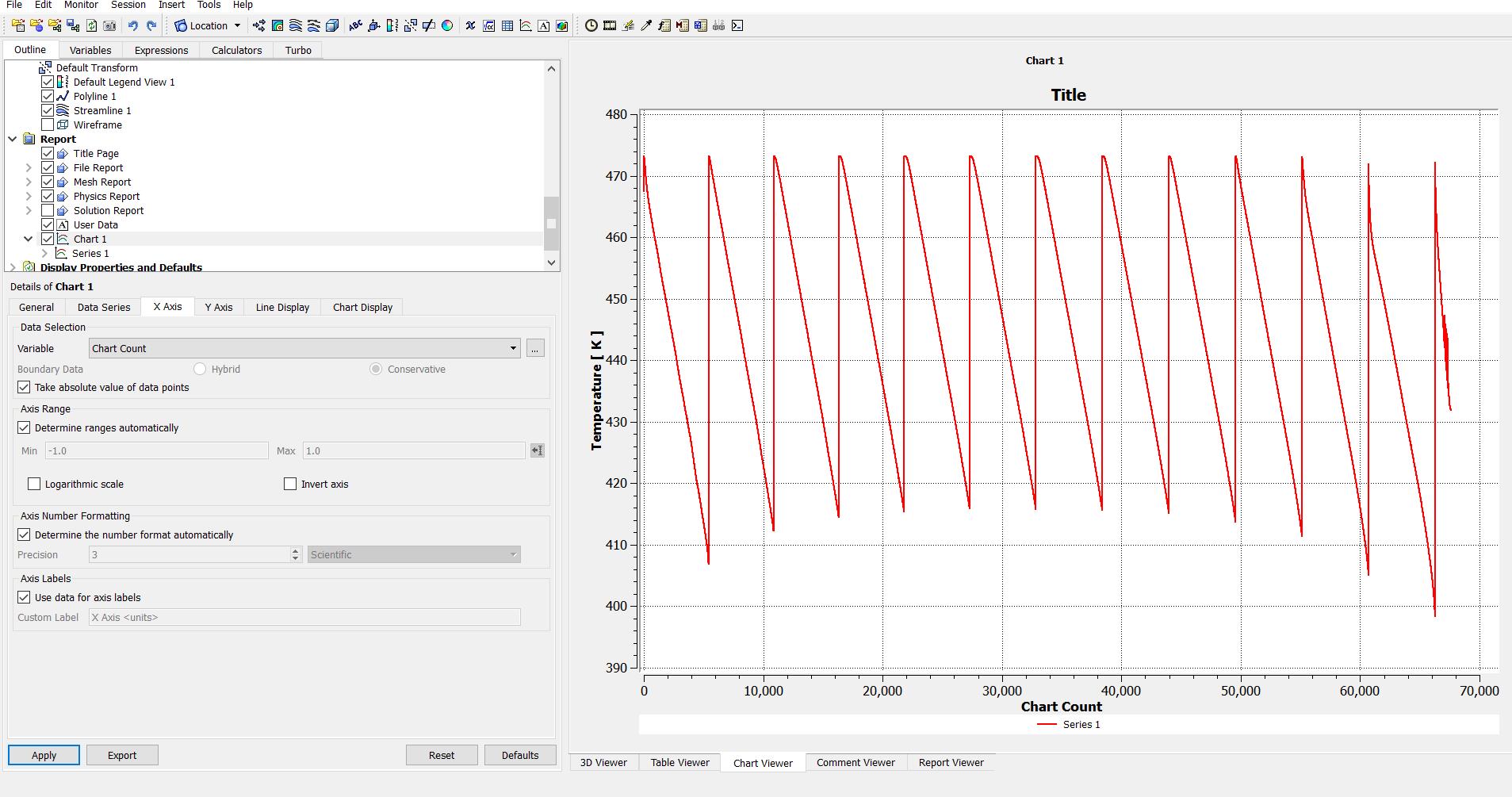

Hello, I am sorry if this is very basic question and I am new to ansys Fluent. I have done simulations of Spiral Plate Heat Exchanger and I want to extract the temperature data along a curve as a function of spiral length in CFD post processiong. Is there any way to do it ?
You can create perhaps a streamline and then plot the temperature along it?
Sorry for the late reply but would you please elaborate how to plot temperature along the streamline because I am not getting streamline length as a option in ansys post processing ?
