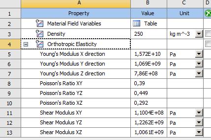

    it's an example of the materials implemented
    edited March 24
    Good to see you have an orthotropic material defined.
    I see the high stiffness direction of this material is along the X direction, which for wood is parallel to the grain.
    What direction does the grain of the wood run on the surface that is deforming excessively?  I expect it is the Global Y axis?
    Please plot the Element Triads and show that the element coordinate system X axis is aligned with the grain direction of the wood on that surface.

    The direction of the grain of the way is in y-axis, because when cutting the piece of wood, they do it radially, so that the force is generated perpendicular to the fiber.
     With regard to that I wanted to ask you one thing, how the direction of the wood is on the shaft and, it is expected that this is the one that handles the Young module with the most value, I wanted to change those parameters by reversing the values in the properties of the materials, but it does not seem to be allowed to use a value on the y-axis (of the Young module) greater than the x-axis. Do you know how if there is any way to solve that?
    edited March 26
    Do what was done in this example to align the original material you defined at first so that the material X axis is aligned with the global Y axis.

    Hi Peter, I already organized the x-axis direction with the global y-axis and the results were very good. Thank you very much for all your cooperation.
