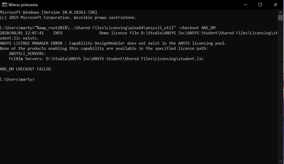

I have a problem with the license, I don't have Analysis Systems in the toolbox. I tried to uninstall, reinstall the application, it did not give any results. I did everything that was described in this post: https://studentcommunity.ansys.com/thread/analysis-system-missing-19-1-student-version/
When I use the Client ANSLIC_ADMIN Utility and when I try to display the license status, I get the information "No SERVER lines in license file. (-13.66)" (I attach to this Screen).
It seems as if the program could not find the license and load it. By entering Workbench-> Tools-> License Preferences, I do not see any license that I have. (Screen 2)
How could I solve my problem?

    Open CMD Prompt and issue the following command
    "%awp_root201%\..\Shared Files\Licensing\winx64\ansysli_util" -checkout ANS_DM
    what do you get ?
  • MartynaMartyna Member Posts: 3
    edited April 2020
    Thank you for your anserw. I got it:

    Open up that student.lic file in the error message and see the expiration date.
    If it's already expired, renew it with the steps here
    https://studentcommunity.ansys.com/thread/how-can-i-renew-ansys-student-version-license/
