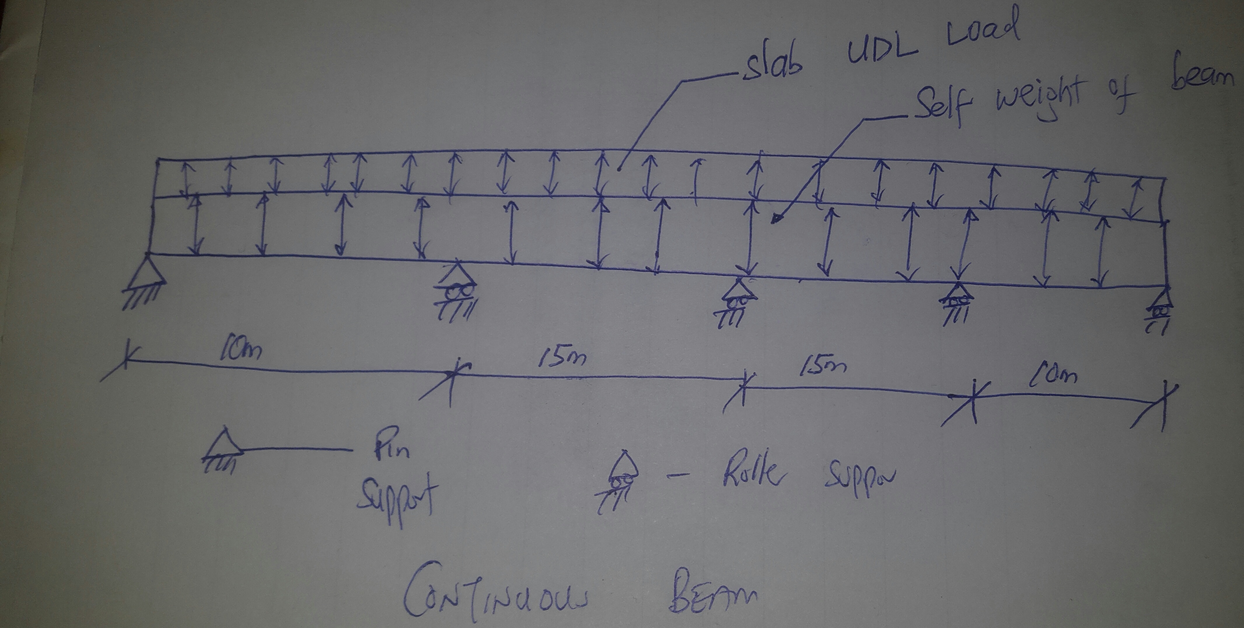

    Hello everyone,
    I'm new to ANSYS, I'm analysing a continuous beam. Will like know the appropriate support provided by ANSYS to apply so as to depict supports in continuous beams.... I can see displacement; fixed and simply support in the frame.
    Also, how do I ensure that the self weight of the structure is the only load applied.
    Thanks!
    edited April 24
    Please make a sketch of the beam and the support you want. Use the Insert Image button to put that image into your reply post.
  • JoenyamJoenyam Abuja, NigeriaMember
    edited April 24
    Thank you for your response. I have attached a sketch of the continuous beam. I intend to use the line beam to model the beam.
