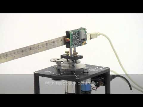

    Hello, thank you for your reply. there is limit of words therefore 3 messages. pardon.here is the link of the model i am trying to make virtually. it will give you better idea what i want.
    Rotary Link
    but in this video there is no extra point mass at the tip of the ruler(non-fixed end). in my geometry i need extra point mass so i can get the response of deformation.

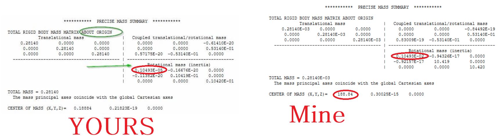

    and as you said the units are important. i am not getting the same values as yours even after changing to m, kg unit standards. changing the standards are not effecting, so it doesn't matter which standard i choose, its changing the value in the properties box but not in the "solution information"
    although its just the conversion issue but still i would like to solve it. thanks
    edited May 15
    YOURS vs Mine
    In YOURS, the units are set to mm, in Mine, the units were set to SI. You can verify that by looking higher up in the Output. You have to Clear Generated Data after you change to SI units before you Solve, otherwise, Workbench sees the model is already solved and will not solve it again. Below is what you had in the output listing.
     MPA UNITS SPECIFIED FOR INTERNAL
      LENGTH      = MILLIMETERS (mm)
      MASS        = TONNE (Mg)
      TIME        = SECONDS (sec)
      FORCE       = NEWTON (N)
