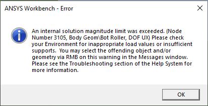

    Okay, I closed the gap as per your instructions and it completely fail to solve at any point, receiving this message.
  • WenlongWenlong CanonsburgMember
    edited May 18
    Hi Itruong,
    It is complaining about the bot roller not constrained. Did you have a boundary condition to fix it?
    Wenlong
