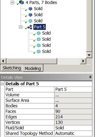

    I found a reason why meshing from the earlier DesignModeler geometry was failing to create congruent meshes.
    The part shows Shared Topology Method is set to Automatic, which is correct but...
    n
    ... the individual bodies had the Shared Topology Method set to None, which defeats the Part level setting.
    All bodies in the Part must be set to Automatic.
