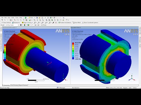

    Also, check out these useful youtube tutorials:
    Coupled Thermal - structural analysis:
    Thermal Contact nonlinear FE Analysis:
