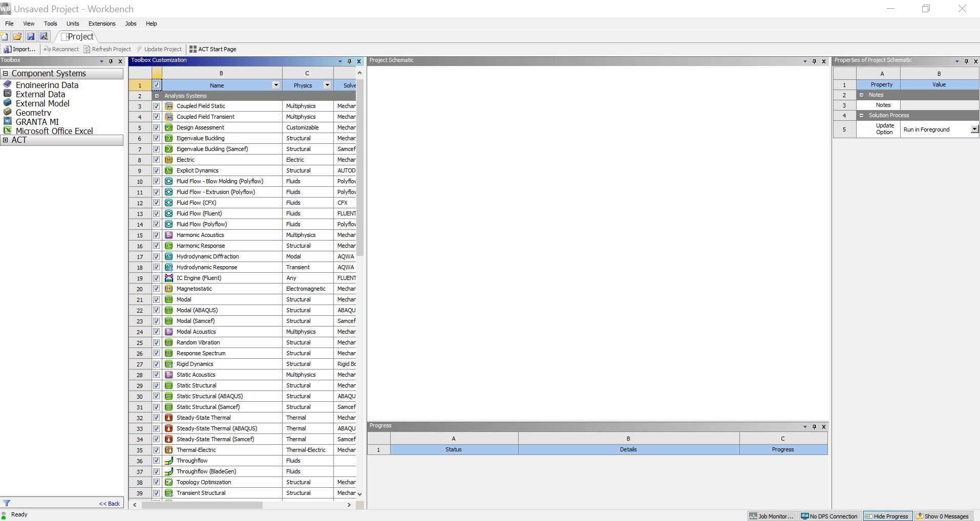

    I think the problem was in downloading the newest version of the software even on my laptop. But then I tried downloading 19.3 version and it successfully installed. But after opening the workbench I cannot see any items in my toolbox. It looks as follows. I don't know if it is the licensing error or something on my side. It would be great if you can help me with this.
  • RobRob UKForum Coordinator
    edited July 3
    If you mean 2019R3 then it should work. If you mean R19.3 where did you get it from?
  • hthakka1hthakka1 Member
    edited July 3
    Ohh I am sorry I misspelled it. It is indeed the 2019R3 version and I downloaded it from the official ansys website. But I am still getting the workbench page as shown above.

    Let me flag an installation expert so we can try to help you here. Please give me some time.

    Uninstall all ANSYS applications you have on the machine, then manually delete your ANSYS installation directory (e.g., C:Program FilesANSYS Inc)
    Open CMD Prompt, and enter the following command
    move "%appdata%ansys" "%appdata%ansys.old"
    As others have stated, make sure your package is recently downloaded (or you can just re-download it again)
    Once you have the package, unzip it and browse to 'prereq' folder, then manually run all the installers here one-by-one. Make sure they are all successful. You can skip the opencl and MPI related ones. You may need to reboot after this.
    Now run the ANSYS installer (setup.exe) with 'run as administrator'
    Do you still see that critical error pop-up ?
    edited July 7
    Thanks for reaching out to me, I did resolve the problem of installation and now there is no error popping up. But after installation, I cant see the analytic systems in the toolbox. In spite it being selected, I cant see it in my toolbox. It would be great if you can take a look at it as well. Thanks again for your time.
