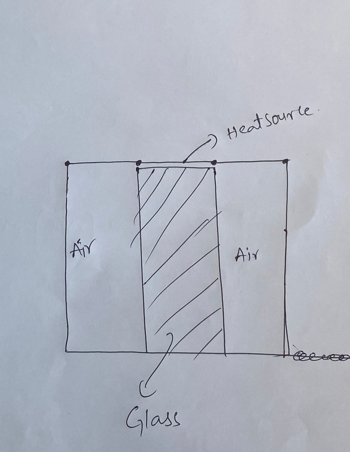

I am simulating melting behaviour of glass substrate with laser as heatsource.can anyone please explain How can I simulate melting and solidification of glass in Ansys fluent.

I tried different examples with vof and without vof, and with solidification but I cannot see any melting effect and temperature distribution from heatsource to substrate.
If there's no heat transfer then there's something else wrong. Are the various volumes connected?
here I attached my 2D model sketch I defined heatflux for heatsource and also I tried with udf please help me with the melting simulation for this model.

So, heat is added to the domain, and the glass should get hot. What's happening in your model?
I cannot see any melting of glass and I cannot see any temperature transmission from heatsource to glass
OK, can you see heat transfer to the domain?
no I cannot see any temperature change
So, even with heat added the domain isn't getting warmer? If that's the case how are you adding heat, and are you adding it in the right place?
if possible could you please simulate that model and attachhere I will be most thankful to you
No, we can advise but are not permitted to give out models or detailed advice. Start with a model assuming the glass is solid and examine the heat transfer. Once that works, swap the solid for "solid" glass using the VOF model and solidification.
