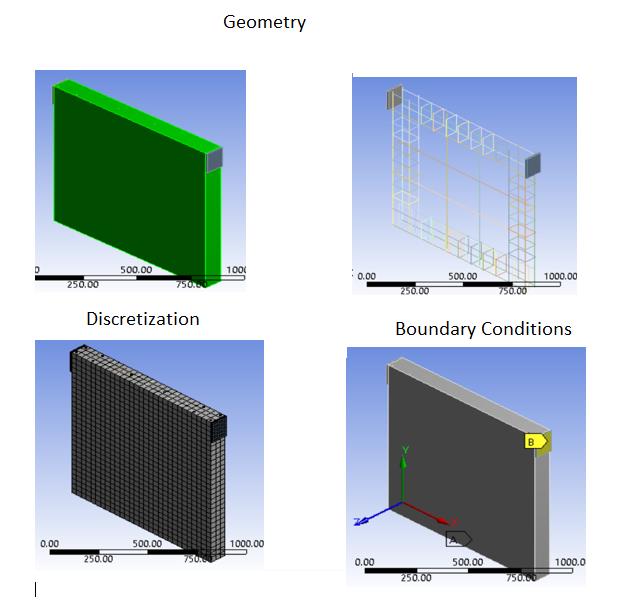

Dear all,
I have used so many concrete material models like TB,concr,matid to TB,concr,matid,DP etc and from the old legacy element to new technology unfortunately non of these responds as needed. the closest response is from the last model i.e. TB,concr,matid with MISO points.
Can someone please advise me if I am making the right approach of testing all these materails models and elements?
The material models are enlised below. Some of them I have taken from ansys help sys examples and some from Mr. Mirghani posts in the student commnunity:

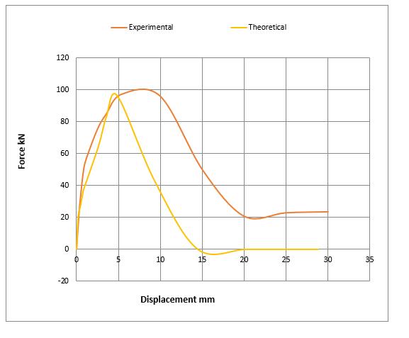

    Thanks for your reply. Can you please tell us more about what experiment curves are you trying to fit? Thanks!
    Wenlong

    I have two more questions: you have shown several material models: Microplane model, Druker-Prager with linear softening, multilinear hardening, etc. Did you 1) incorporate them all into the model? 2) Or just list them to show the models you have tried? If the answer is the 2), can you please clarify which materials combinations did you use in a simulation?
    The second question is: did you have rebar reinforcement in the concrete? If yes, how did you model them?
    Thanks,
    Wenlong

    Thank you for enlightening me, please find a copy of the curve and the model screen shots attached as advised. Please advise me if there is any more information needed.
    Kind regards

    Dear Wenlong,
    I thought loading information could be of use. The load was applied not only on the plate marked as B but also in the "mirror" plate at the opposite end, at the same time. A graph of displacement controled load is attached. Thank you for your consideration.
    Kind regards,

    Thanks for sharing the information. Looks like you already have some good preliminary FEA predictions. (Is the theoretical plot the FEA result?). It seems your model predicts a very good peak force. It is just the softening part doesn't match very well, which means your model dissipates less energy than the experiment.
    You mentioned the closest result to the experiment is by using "TB,concr,matid with MISO points". You have probably calibrated the material model input with your experiment data, right? How did you define softening using this model?
    Apart from this wall shear test, have you conducted any smaller-scale test on the concrete (to obtain material parameters)? Do you have output information (like force-displacement plot) from these tests? I mention this because to calibrate and verify your concrete material model, it is better to start with some smaller test. It allows you to eliminate the influence of the effect of rebars and other complex condition so that you can make sure the concrete model is right. For example, for some plasticity experiment data, after I extracted the material properties, I would run a dog-bone simulation and compare it with the experiment, and only after making sure the material model is defined correctly, I would move on to apply that plastic material to some large-scale complex model.
    If you don't have other small scale tests, I would play with the softening law's parameter to see if it will give me a better match.
    One quick question: So you are applying cyclic loading to the concrete wall, then why is the force vs. displacement plot monolithic?
    Wenlong

    Thank you for your considerations. Yes, preliminary predictions are thankfully conforming regarding peak forces. Yes, the theoretical plot is the FEA result. You have pinpointed my concerns before I mention it which is the energy dissipation.
    The conforming results are from TB,conc,matid and TB,MISO,matid but it would not allow definition of the softening part meaning the analysis will immediately fail as soon as it is run.
    Apart from the main experiment specimen dimension (1x1x0.1m) cubes and cylinders tests were conducted based on which the MISO points were developed. I tried to model uniaxial crush tests we had on the cubes but it will fail immediately without any convergence.
    You are absolutely right; the actual response is hysteresis and the load-displacement is actually an averaged of the envelope of the hysteresis response developed for comparison reasons.
    Thank you for the second post as well, I used constraint command CEINTF to tie all the reinforcements except vertical bars. Since vertical bars had bond-slip in the experimental specimens I modelled the tie with the nonlinear interface spring element Combin39 in y direction using EINTF command for offset nodes. The vertical bars were also constrained in x and z direction using CEINTF command. Followings are the snippets:

    I tried combin40 as well but to no avail meaning not much correspondence with the experimental results. I tried quite a few bond-slip models from the literature for Combin39 before the model in the snippet could produce the FEA curve.
    I used the bonded contact type with MPC formulation for the steel plates which worked very well and resolved the non-convergence issues. I used Mesh200 and Reinf elements but it produced a non-conforming result meaning it will not correspond to the experimental results.
    Please find a couple of screen shots for MISO and Hysteresis response attached.
    Is there a way the model could produce a more corresponding amount of energy dissipation ?

    Hi Wenlong,
    For some reasons I cannot see/open the two screen shots i posted earlier so I am posting them again just in case.

    Please find a few screen shots from the analysis attached.
    I tried quite a few number of models borrowing from the help systems and the work of the others however non of these models are behaving like experimental curves except the classic model but without the softening and with a significantly reduced energy dissipation which is begining to worry me if this model could be improved at all.
    I really wholeheartedly appreciate your time and considrations.

    Sorry, I don't have any further comments about the high reaction force predicted using the DP model. Maybe keep adjusting the parameters?
