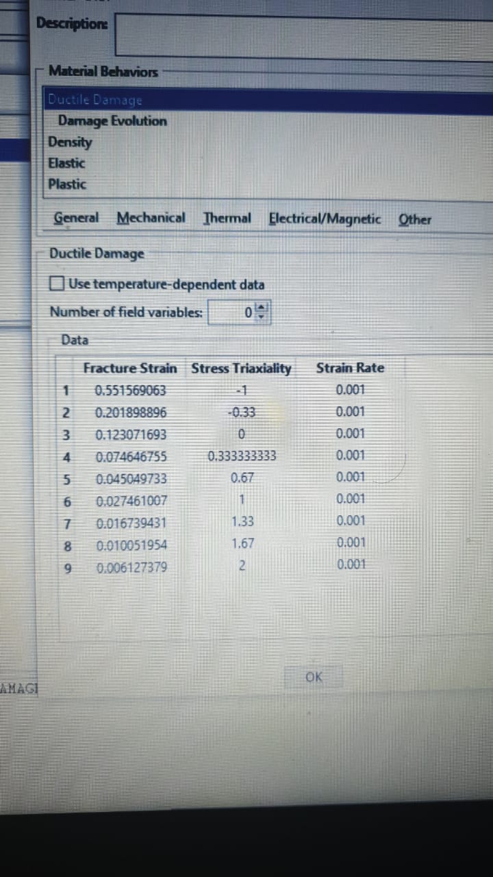

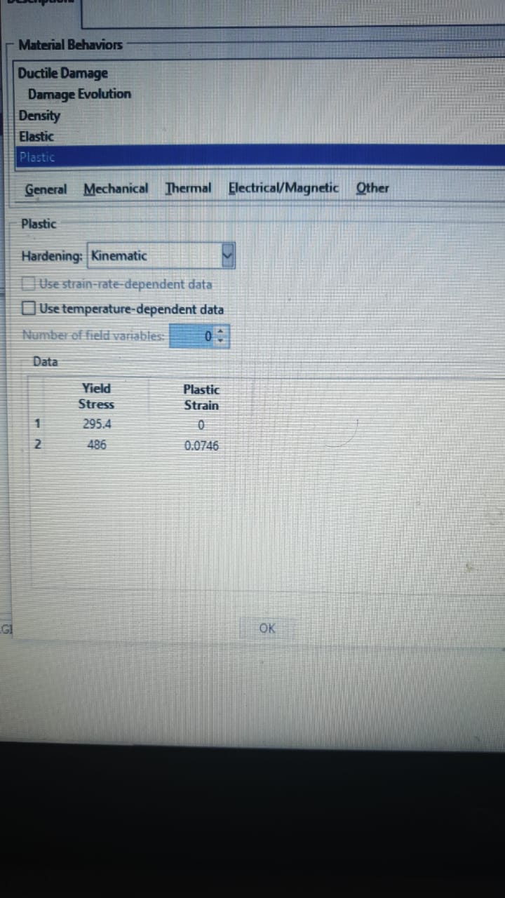

How could I define a fracture damage material in Ansys
