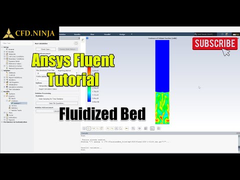

I am simulating a multiphase system (gas-solid using Eulerian Granular, Model: Realizable k-e, Standard Wall Function) with a air inlet velocity of 13 m/s. I want to simulate it as a fluidized packed bed reactor (without inlet and outlet flow of plastic pellets) and with "Adapt" - "Patch" I fill the reactor with plastic pellets (see image).
I have a problem during the calculation. I get a floating point exception error (turbulent viscosity limited to viscosity ratio of 1.000000e+05). I refined my mesh looking at skewness and orthogonal quality and it was really fine. I looked at some other forums and it seems that the k-epsilon model is probably calculating erroneously or my solver/controls setup is not right for my simulation.

    Basically I am creating a secondary "fluid" (plastic with its density, I don´t change the viscosity), adjust the secondary phase with "Granular", add the diameter and use syamlal-obrien for granular viscosity. After initializing I use the function "Refine/Coarse" and mark the cells where the plastic pellets should be. Than I patch the marked cells with volume fraction of plastic pellets, change my interaction phase with drag coefficient syamlal-obrien-para and then I start to simulate.

    What volume fraction did you use? If you patched at the packing limit it'll do interesting things: try 0.01 less than the packing limit.
  • SundraSundra Member
    edited July 20
    I used a volume fraction of 0.578 and void of 0.422. The packing limit is 0.63

    I also reduced the time step size to 0.001s (tried 1s, 0.1s, 0.01s) and at the end I will get the same error but way later
    edited July 20
    I did some research and probably my dt was  to big. With 0.001s I had the best "results" yet but in my case I might need to reduce dt even more. The minimum cell size is 2x10-5m and the maximal cell size is 0.065m. So I am trying to simulate with the "Adaptive Time Stepping" method and I am getting a physical dt varying between 1x10-5s to 5x10-5s (inlet velocity of air is 12.6m/s). At the end I will have a solution with a flow time of maybe 1s if I iterate 20 000 times... Not good not terrible
