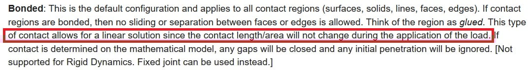

    3) Question about info from help file.
    Does that mean that the results from non-linear analysis ( Large deformation on + NL material)  of model with bonded contact will be inncorrect ?

    3) Bonded contact can be used in Large Deflection nonlinear analysis where large angles of rotation are present. Bonded contact should be avoided if material plasticity is present in the area of the bonded contact.  The help explains that you can have a Linear Model, which solves fast, and also use Bonded Contact.  That is not true if you use Frictional Contact.

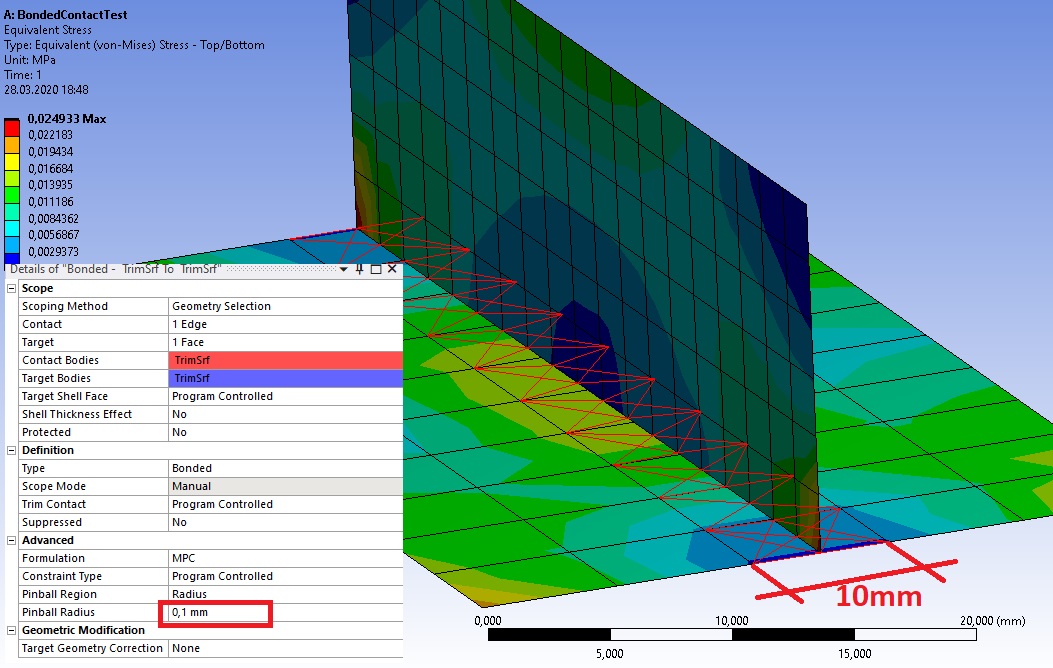

  • jdrozdowskijdrozdowski Member
    edited March 28

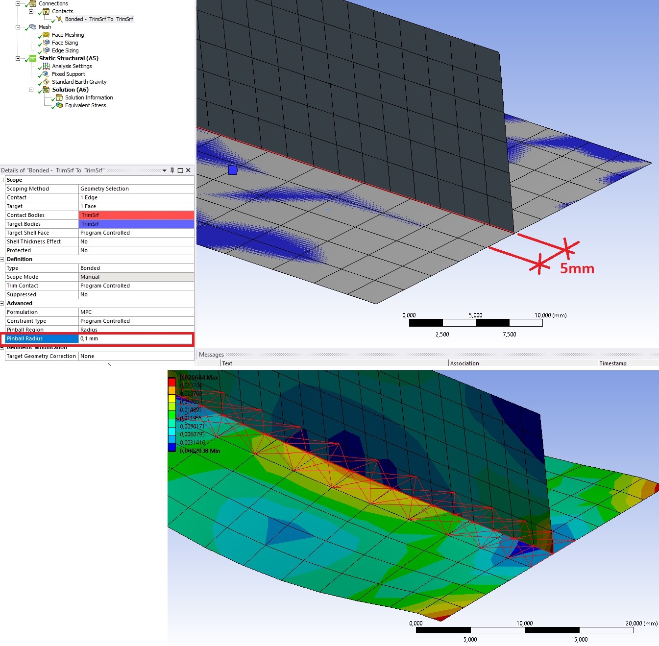

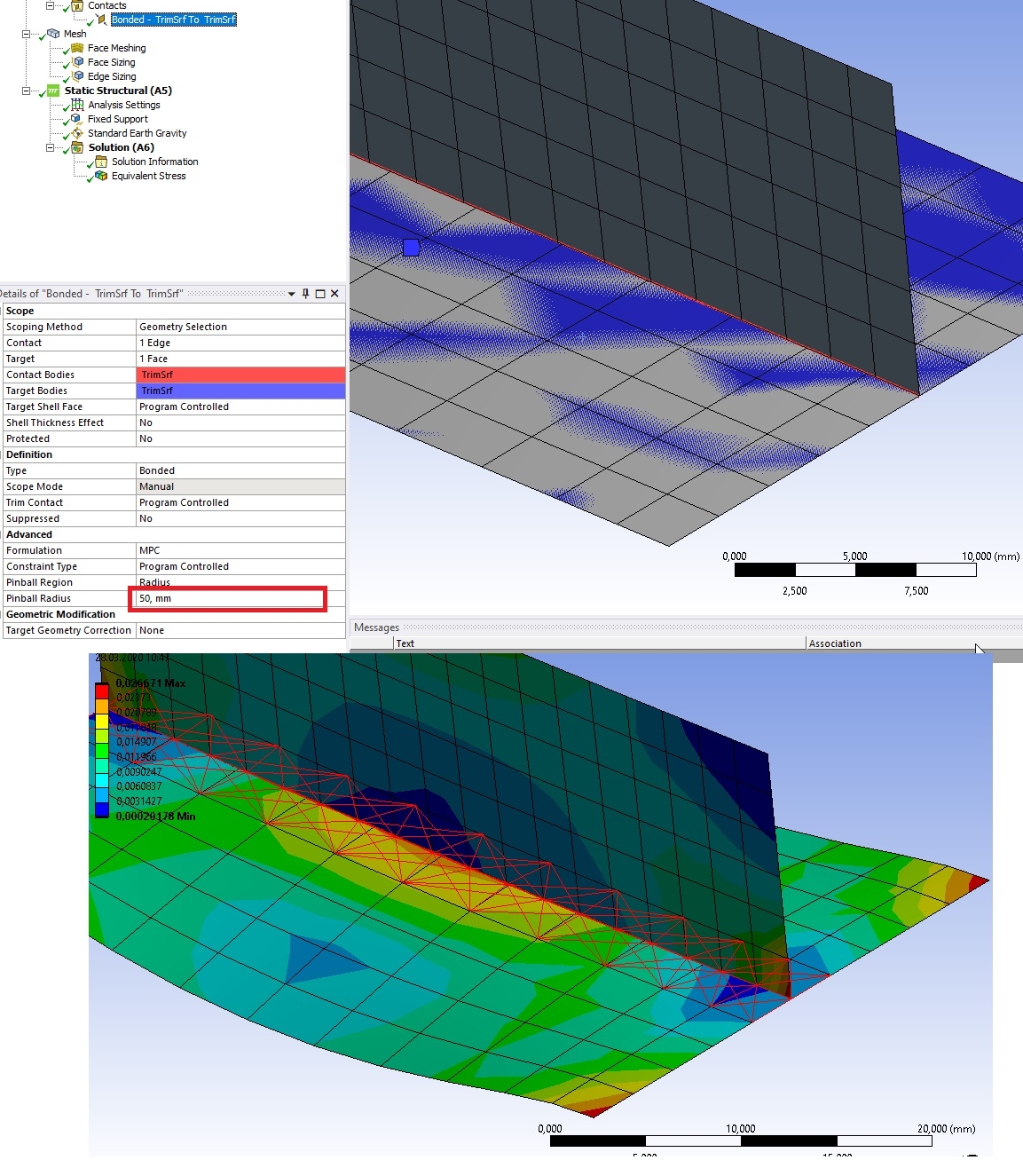

    Hello. Thank you for comprehensive answer. I made the test that you described. If i understand well red lines represent constraint equation which are connecting nodes that are inside pinball radius region? But they are NOT rigid body elements, right ?
    I made some tries with different pinball radius but nothing changing. Why is that ? Please look at the picture below there is no difference between 0,1mm radius and 50mm radius.
    The red lines are only visible with MPC formulation. And what about other formulation ? What they are doing with nodes ? If I leave formulation as Program controlled there is no red lines so I assume that MPC formulation is not the default one.

    Hello jdrozdowski,
    Thank you for doing the test!  I described what I expected to happen, based on descriptions in the ANSYS Help system like this...
    so it is interesting that it did not work the way I expected.
    From your test, my new understanding is that there must be an algorithm that decides when a node has "enough" connections and stops. I don't know for sure.
    One part of the test, which is not important to do as it only can cause a problem, was to set the Pinball radius small, which you did, but that only works if there are an odd number of elements (like 11) across the width, which leaves no nodes at the centerline and makes a gap between the nodes on the vertical and nodes on the horizontal. You have 10 elements across the width, which create nodes along the centerline and no gap.
    These MPC Constraint Equations are described in Chapter 15.14 of the Theory Manual of the Help system, which I don't find that helpful. MPC stands for Multi Point Constraint. This creates a set of equations, using Lagrange Multipliers, to enforce a set of requirements on the kinematics of the set of nodes on either side of a contact. MPC is similar to RBE3 elements that distribute a force to a set of nodes without adding any stiffness. This is in stark contrast to the CERIG elements that define a rigid region which is used in a Remote Displacement or a Joint when the Behavior is set to Rigid. This does add stiffness to the model (NASTRAN calls it an RBE2 element).  Remote Displacements and Joints can also have the Behavior set to Deformable, then it uses RBE3 elements that don't add stiffness.
    The default Formulation for Bonded Contact is Augmented Lagrange according to the Help system.  The reason I like MPC is because I can do a visual check of where the contact may be missing in some areas and I can increase my pinball region to cause it to connect.

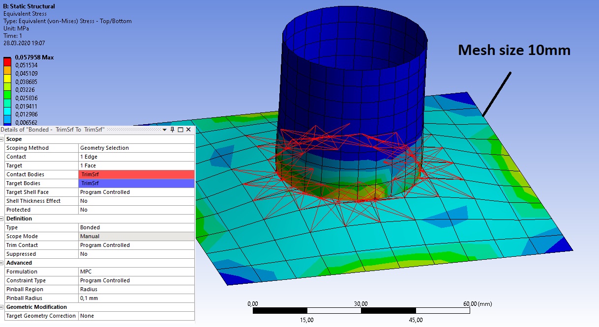

    Here is another test you can try if you want. Make a cylindrical sheet body at the center of a flat  square plate. This will create conditions where there is a large variation on the distance between nodes on the contact side and nodes on the target side of the contact. Play around with element size on each body.  Flip the Target-Contact side of the contact by a right click on the contact. Try a number of different Pinball Radius values to see if you can get an intermittent bond around the circle.

    Hello. Thank you very much for all helpful information that you provide.
    I made both test.
    Somehow in both cases it is just not reacting for changing the pinball radius.
    edited March 28
    Great, thanks for the test results. I don't know why the Pinball radius is being ignored.
    If in the cylinder on plate model, you go back to SpaceClaim and on the Workbench tab, click the Share Button, the circle will imprint on the plate, then you can go back to Mechancial, delete the contact and see the benefits of Shared Topology, which I prefer over Bonded Contact.
