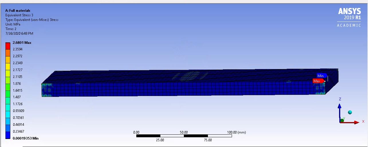

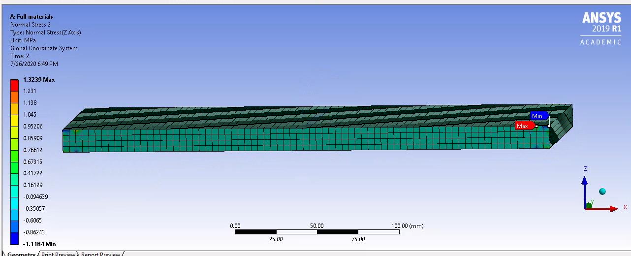

    I want to ask though. What are the differences of Equivalent stress (Von-Mises) and Normal Stress ? They have different values for the core that I am mostly interested in since its a solid block but with Orthotropic properties (AL 5056). Also, when I press play those values change.
    Equivalent Stress:
    Normal Stress:
    Should I add any other solution specifically for the purposes of looking if the honeycomb works as intended ? I just want to show that this method works and that its not necessary to model an actual 3d solid honeycomb.
    Thank you for your time.
    Michael
    edited July 26
    Read a Mechanics of Materials / Solid Mechanics / Strength of Materials textbook for the equation that transforms the 3D state of stress with 6 components (3 normal stresses and three shear stresses) into a single value called von-Mises stress and how that is useful to compare the 3D state of stress in a complicated part with complicated loads with the simple state of stress in simple tensile test coupon in a tensile testing machine that measure tensile yield strength.
