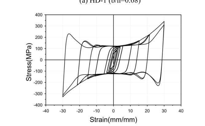

Hi, i spent days to get full stress-strain hysteresis loop but i still do not have the solution. I have chosen nonlinear characteristics on a steel honeycomb element loaded with opposite sine forces with increasing amplitude during time. Since i have to calculate the energy dissipating characteristics i need to plot the total stress strain hysteresis loop. So far i get the results only with positive values (see screenshots). I have tried with even simpler model of a steel stick but the problem stays the same. Can someone suggest a solution? Tnx

    Peteroznewman, i have defined nonlinear structural steel with bilinear isotropic hardening but i assume that at least the loop have to follow the rule of the material, so later on i will play with the type of nonlinear material. The goal is to get the Strain vs  Stress plot of the whole model as in the attached photos.

    I tried your suggestion but nothing happened. I started again with the simplest form of exercise, a steel cube loaded with + and -  displacements. The goal as i said before is to get the stress vs strain hysteresis loop. The material characteristics, meshing, boundary conditions and some of the results are shown on the photos.
    i do get the strain energy from the plot but i need the full stress strain loop.
    What should i exactly plot in order to get what i need?

    That's great that you made a special cube model to study the material properties! I've been doing that myself. There is an improvement you can make. Delete the Fixed Support and replace it with a zero Z displacement support, then supplement that with a zero Y displacement support on the face normal to the Y axis, and a zero X displacement support on the face normal to the X axis.  Now when you apply a displacement on the face opposite the zero Z face, the cube is free to expand and contract due to the Poisson's Ratio.
    You can't get the plot you want inside ANSYS. You have to do some manual labor to get it to come out the way you want. The example I show below is for this material. I made the modulus ten times more flexible so the slopes are not so steep on the plots.
    I then applied the following displacement time history to the face on cube that is 112.4 mm long.
    I requested the Normal Stress, the Elastic Strain and the Equivalent Plastic Strain, shown below.
    Notice that the last plot, Equivalent Plastic Strain, doesn't look like the others. That is because equivalent results are always positive, but to make your plot, we need signed plastic strain.  Maybe one of the ANSYS members who knows more than me will tell us the result to use, but I just manually flip the plastic strain to the opposite side by multiplying the hump that should go down by -1.  Then I get a signed plastic strain.
    Add this to the elastic strain to get a signed Total Strain.  Now you can plot the Stress vs signed Total Strain.

    It is crystal clear now. Thank you both very very much for the help. I managed to get the plot that i need. Now i only have to adjust the material properties and the meshing.
