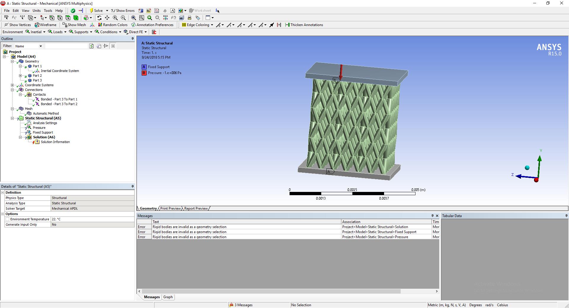

Top plate and bottom plate are rigid bodies, Middle body is flexible and i am unable to define the contacts between them and automatic contact is not working in this case. Kindly help in this regard
    edited September 2018
    Contact between rigid and flexible bodies must be Asymmetric. The Target face has to be on the rigid body while the Contact face has to be on the Flexible body.
  • edited September 2018
    Yes, also checkout note that you can't select those 2 rigid bodies at once:
    Multiple rigid bodies cannot be selected for the Target side scoping of the contact pair. The selection of multiple rigid bodies for the Target invalidates the Contact Region object and an error message is generated following the solution process.
    Check out this section of the manual.

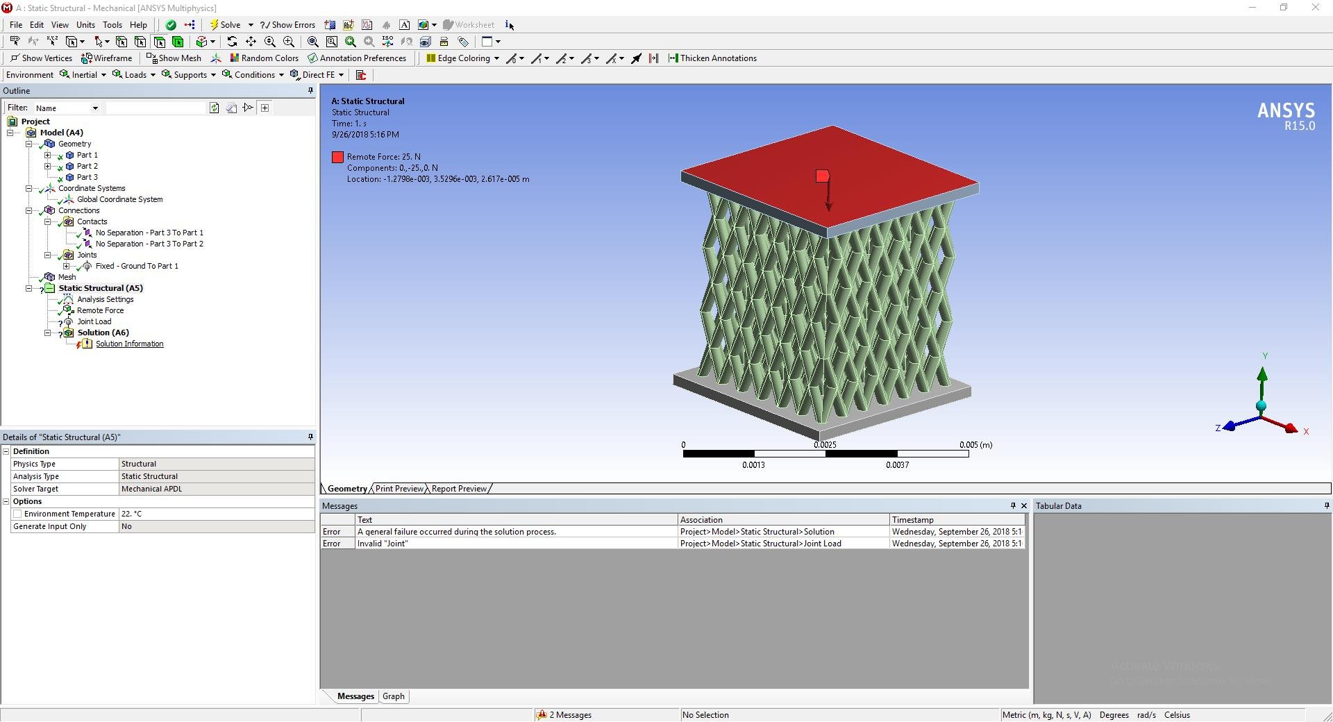

    Now I have sorted that error but now i am getting the error rigid bodies are invalid as geometry selection
    You can't use a Fixed Support on a Rigid Body.
    You have to create a Fixed Joint to Ground.
    You also have a ? on the Pressure, so delete that for now, then the model might run.

  • rgpatchirgpatchi HannoverMember
    Hi Kartik,
    I see you have a Joint load in the tree (with a ? mark). This is not valid for a fixed joint. Also, it is not necessary in the present case.
    Please delete that and try to solve again.
    Best regards,
    Rohith
  • dkartikdkartik Member
    edited October 2018
    Dear all
    Thanks for your valuable comments contact problem is solved for now. But i need to apply pressure on the upper plate then it is saying rigid bodies are invalid as geometry selection. again with remote force it is working fine but i wonder why we cant apply other form of loads .
    Thanks and Regards
    KD
    edited October 2018
    Dear Kartik,
    A rigid body is created with a single point and a coordinate system, so it has no surface area to apply a pressure to. A flexible body meshed with solid elements has faces on which a pressure can be applied.
    While target contact elements can be added to a rigid body, they are not programmed to allow a pressure load. For a flat surface, you can multiply the pressure by the surface area and apply a force at the center of the area to get an equivalent effect on a rigid body that has target contact elements.
