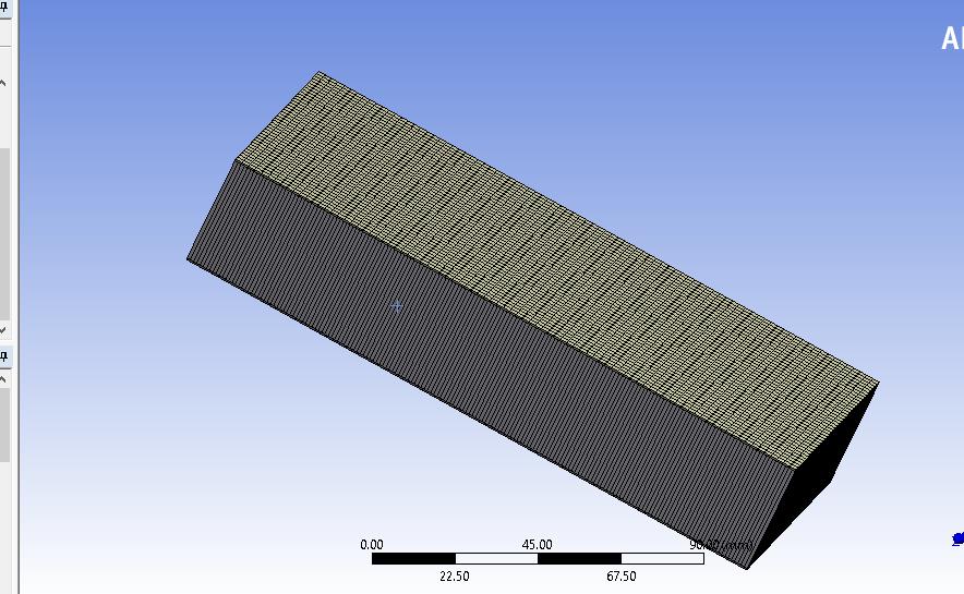

Difficulty in meshing and solving honeycomb sandwich in ansys workbench
I have modelled a honeycomb sandwich according to size but when i mesh it in mechanical it takes too much time and also mesh generated is very poor and in modal analysis the result i got is wrong.
I am attaching the geometry for reference please help me by checking the geometry.

    Hi Kumar,
    I put this image from your model here because Sandeep is not permitted to open attachments. The top skin is hidden.
    You have not sliced this cleanly out of the bulk honeycomb since once cell is not closed.
    The proper way to model this is with surfaces at the midplane of each solid face, not with solid bodies.
    You ran a Modal analysis without holding the part, which is allowed and simulates how the part would vibrate if it was floating in space. When you do this, you have to request more than six modes, because the first six modes are the rigid body modes. You need to request seven modes to see the first natural frequency, but that might be a little off because of the missing face on one cell and the fact that you should have built it with surfaces instead of solids.
    Both SpaceClaim and DesignModeler can extract midsurfaces, but they won't do the all the surfaces at once like my NX CAD system. Can you get a midsurface model from the CAD system that made that geometry?

    I opened edited assembly 1 22 midsrfc.x_t and see that it has three different thickness walls. Is this intentional?
    When you sliced off a section of honeycomb, you left hanging faces like this.
    It's best to delete the leftover face.
    After cleaning up all the hanging faces, I have this solid model.
    After using the Midsurface feature in NX, I get this set
    I could not Sew (equivalent to SW Knit) these surfaces into one body. That's okay, I will see if DM will connect the surfaces using Shared Topology.
    Here is the parts in DM using Share Topology.
    Here is the mesh in Mechanical. We can see that Share Topology failed because there are red lines at the Y intersection.
    There is a Node Merge feature that can connect things together. The purple is correct for the Y connections.
    I am a bit concerned about the black line on the one edge that should be red.
    Unhiding the Top and Bottom sheets shows that the Mesh Defeaturing has connected those sheets to the honeycomb where the lines are black not red.
    I defined contact elements to connect the top edges of the honeycomb to the top sheet, and the bottom edges to the bottom sheet.
    Attached is zip file with the Parasolid and an ANSYS 19.1 archive.

    edited October 2018
     Hey Vishal,
    You have clean geometry and a good mesh. The element quality is fine. It is not necessary to get perfect squares.
    Since Node Merge has connected the nodes, there is no need for any Contact elements. Delete the two bonded contacts.
    You requested 30 modes. Do you know this trick to generate the mode shapes? RMB on the blank square in the Tabular data.
    I recommend you characterize the honeycomb stiffness properties by fixing one end and applying a point mass at the other end and computing the modal frequencies for that case. I put a 1 kg mass on one end of the honeycomb sandwich beam and fixed the other end, then I got some sensible Modal results.
    The first mode was twist.
    The second mode and third mode was bending sideways.
    You could compute the stiffness of each of these motions to characterize the honeycomb sandwich.
