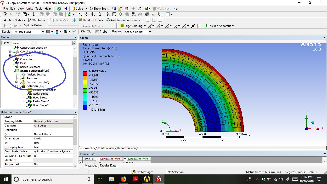

    1. Sir i have changed geometry into plane strain. But here there is only one load applying that is the pressure. But my aim is to analyze the thermoelastic characteristics. So i want to apply temperature as well as pressure too in this model.
    2. Are the results (stresses) we got from my model valid ? i am just tensed about it. It would be very helpful if you can assure me about the radial stress, hoop stress i get from my model are ok.

    2. Sir if i want to get the stress for the temperature only then how can i get it from my model. I tried to apply in the steady state thermal then i can get the stresses. Then i tried in the static structural ,there i applied thermal condition and applied no pressure.Then i got stresses. Is it okay? I meant if i want to apply 0 internal pressure and 1100 deg cel internal , 100 outer temp and then want to get the stresses then how will i do it?
    3.sir when i linked as you told earlier for the plane strain then i got the stresses for pressure only. There is no temperature applied. But i want thermoelastic characteristics that means the stresses for the temperature and pressure simultaneously. then how will i do it.

    1. I'm not going to validate your mathematica code.
    2. If I suppress the Pressure in your 3-layer model, the Static Structural model solves for the thermal stress without error. In your Main model, you have the stress from both the pressure and the thermal load in the Copy of Static Structural system C.  You don't need system D, Final one.
    3. In Copy of Static Structural system C, you have both Pressure and an Imported Temperature load. Why do you say there is no temperature applied?
    I don't know where the last image in your post came from. The Main model has solved correctly.
