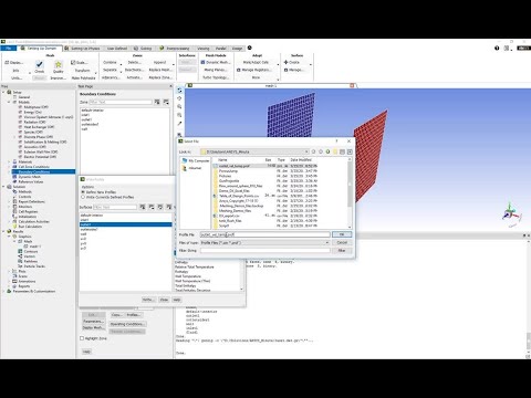

I'm doing 2D-axisymmetric turbulent flow around a ramp 25°. For this I have to apply fully developed turbulent velocity profile at the inlet. First I run the simulation with a constant profile.
I want to extract the 2D velocity profile from  FLUENT calculation and load the velocity file as the input, but I don't know how to get the velocity file
1-: Is it  possible to export a velocity profile at a  a simple line in a 2D model in CFD-Post?
2-Is how this fully developed velocity profile can be correctly applied at inlet in next simulation?
