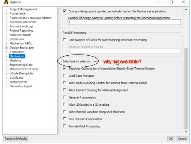

    Hi, Can ansys 19.2 run thermal topology optimization? Where can I find it? Thank you so much.
  • CambridgeCambridge Member
    edited November 2019
    Hi, can ansys 19.2 run thermal topology optimization? Do you have any tutorials? Thank you so much.
    Thermal Topology Optimization is not available in 19.2
    It is available in 2019 R1 and later.
    edited February 19
    Dear Peter,
    I am now using ANSYS 2019R2, it has TO for thermal but with some limitations. Do you have tutorials about TO using workbench? Thank you so much.
    regards
    edited February 19
    I don't have anything. Search on YouTube and the ANSYS Help system.
