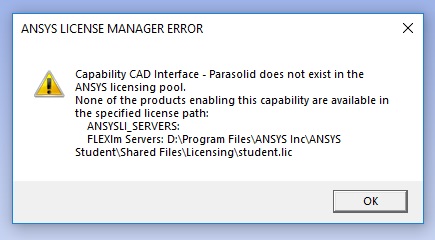

    I just installed student version 19.0 and started the Workbench and when I imported .stp file and run model, it wrote me this (picture). And geometry wasnt loaded.
    I reinstaled it, deleted all, in app data too. Anything helped. I am desperate and please for help.Error
  • vganorevganore Pune, IndiaAdmin
    edited April 2018
    I assume you are trying to load Parasolid file. Please have a look at this thread.
    https://studentcommunity.ansys.com/thread/unable-to-import-parasolid-file-through-workbnech/
