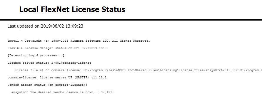

  • shconshcon Member Posts: 15
    edited August 2019
    Hello Win,
    Here are screenshots from the License Management Center and the license.log file.
    LMC1
    LMC2
    license_log_file_error
    It appears the time is incorrect in this file if 00:006 is 36 seconds after midnight.  The time should be 1:05 pm.  Should I remove the port number after ansyslmd in the license file?  I do not have FlexNet software...
     Here is another screenshot...LMC3
    Shaynee
  • tsiriakstsiriaks 3240 El Camino Real #290, Irvine, CA 92602Forum Coordinator Posts: 3,071
    edited August 2019
    Shaynee,
    You don't have to remove the port number but you have to make sure the port is available and is not blocked by anything.
    Also, you may have to make sure there is no stuck processes running. Kill all of these processes: ansysli_monitor.exe, ansysli_server.exe, lmgrd.exe (for ANSYS only), and ansyslmd.exe. Then try starting the License Manager again and check the FlexNet Debug log.
    edited August 2019
    Hello Win,
    FlexNet Licensing is running...had to do the taskkill twice for some reason.  I'm still getting the Flexlm -96 error when I try to open HFSS15 on another computer.
    Shaynee
