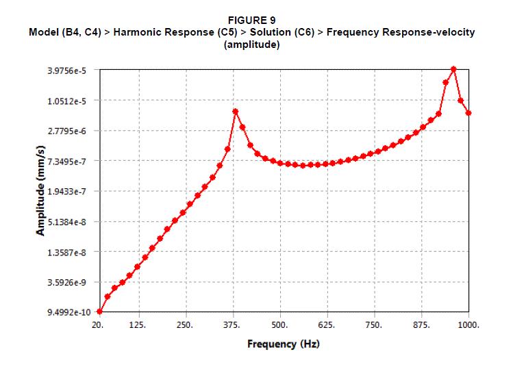

I had a problem to converting spectrum data to Rms Value, i did not want the negative value to be appeared , how can i do it?

    I am not sure if I understand your question. RMS means root mean squared. You will square the value, so eventually everything is positive under square root. https://en.wikipedia.org/wiki/Root_mean_square

    RMS is more for summing stresses in response spectrum analysis (PSD or response spectra/earthquake say).
    I think you mean amplitude.
    The FRF is a complex function/number, and you are showing the imaginary part of that complex number.
    Complex numbers and FRFS can be represented thus by a phase and an amplitude (positive number). Thus for complex number z:
    z = x + i*y = ¦z¦*exp(i*phase),
    https://en.wikipedia.org/wiki/Complex_number
    So you need/mean the amplitude of the FRF which is:
     ¦z¦=sqrt(x^2+y^2)
    You can set amplitude under details, options, and display in the frequency response.
    Search the ansys help manual for:
    Frequency Response and Phase Response

    Thank you for your help sir, i had change to amplitude, are you sure it indicate the RMS value, since its look too different between the imiginary result before

    how can @Hadi96 ,you get a amplitude graph ?
    have to apply the rotating force and fixed rotation
