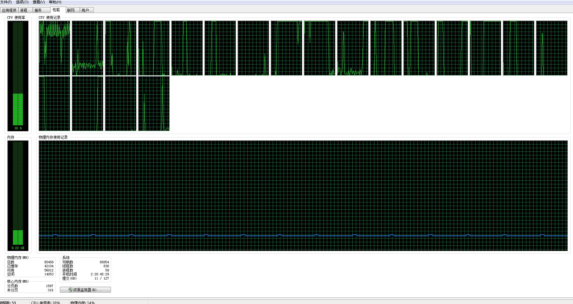

    By the way ,do you know something about how to make full use of the computer Configuration.My computer is 20 cores.
    I wonder how to make full use of it.and  i need do the dynamic explict   in ansys.The analysis type is 2D plain strain.It is time -consuming when the number of meshing grid is up to 10 thousand.Sorry for my poor English,I hope I make myself clear
    edited December 2017
    Does your computer have 20 cores or 10 cores with 2 threads on each core? The Task Manager will show twice as many CPU usage bars as there are physical cores if hyperthreading is enabled. I disabled hyperthreading on my 16 core machine. ANSYS will only use one thread per core and if you look in the solve.out file, it will tell you how many physical cores it can detect.
    ANSYS solver licenses come with the ability to run on 2 cores.

    what do you mean hpc lisence?I think I don't have it .I don't know how to  runa job with 8 cores or more,what  2 threads on each core ?embarrassed...........
    While it  is knowed that autodyn  can't run with  Parallel Computing,I know how to set up more cores,just like  you show above.
    I mean when you do explict dynamic in ANSYS, its solver is AUTODYN. So how to improve the computing speed  considering that I have set up more cores.espceilally  in 2D problem which cannot  use Parallel Computing.
