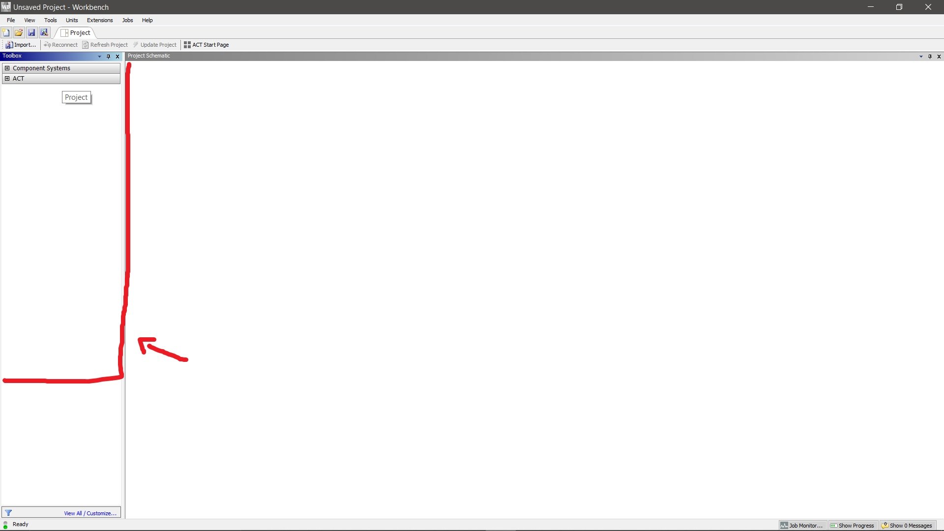

Not seeing any items in the ANSYS Workbench toolbox?
After reinstalling ANSYS Student 18.2 recently I also ran into the issue that some have reported that Workbench opens up with no toolbox items. I initially thought it was an installation problem or license access problem. In my case I found that the UI had launched in a custom view mode, hiding what I was expecting to see. My problem was solved by selecting View > Reset Workspace

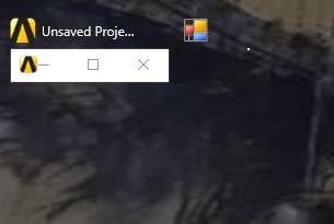

I can't open workbench
Did you just install ANSYS? Which version (17.2 or 18.2)? Which license (Student or other)? What OS version are you using?
I was using it, and this problem just happened, so I reinstall it again. version 18.2, student

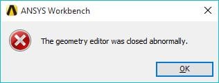

this also appears, when I try to open it. so, If there anything I should do.
This thread might help you if this is a graphics card issue.
https://studentcommunity.ansys.com/thread/geometry-editor-was-closed-abnormally/
hello, if someone can help me i appreciate so much. My problem is when i open the Ansys Students the toolbox dont have the analysis sistem, just appeared component systems and ACT. I checked the firewall of windows and it´s ok, but i think the problem is relacionaded with the license.
Hi did you find any solution to it? I just met with the same problem. It will be of great if you could help.
Which version are you using?
Hello Mr. Rob. I also have the same problem. version 2020 R1 please help me.
Hello sir, I followed the steps seen in the forum and got it solved. Thank you so much for your reply and very sorry for the late reply.
