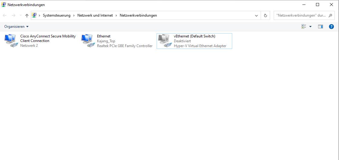

    Hallo everyone, I am reposting this in this tread for more helping hand,
    I faced this same problem for past two weeks and finally solved it.
    My Fluent keep pointing the error " Fluent application failed to start".
    and in the Fluent log box says "Unable to connect to external socket: Error during socket creation Opening output fil".
    Based on this I assumed there is a connection failure between a Host and client.
    My set Up is a Client Side on Windows 10 with a VPN (Cisco) where i am receiving the license for Anysy from my university.
    I did everything as mentioned turning off firewall, reinstalling as admin, reconfiguring my VPn. but neither was working.
    Solution
    In the end , i traced back the problem to my Hyper-V Virtual Adapter Ethernet. If you are a Android Studio developer most probably you have this one too.
    Deactiavte it as i showed in this image. After that restart the pc and all error will not show again.
