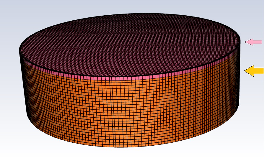

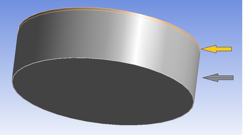

    I am also attaching some screenshots.
    The first one shows the fluid bodies (air in pink, water in orange)1. Fluid Model
    The second shows the tank structure (tank wall that interfaces with air in orange, tank wall that interfaces with water in grey)2.Tank Model
