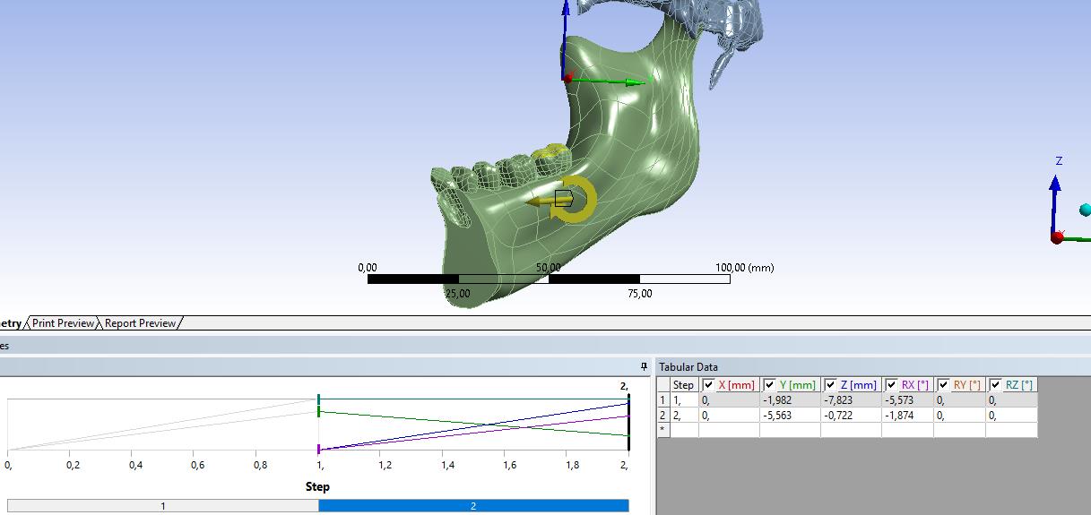

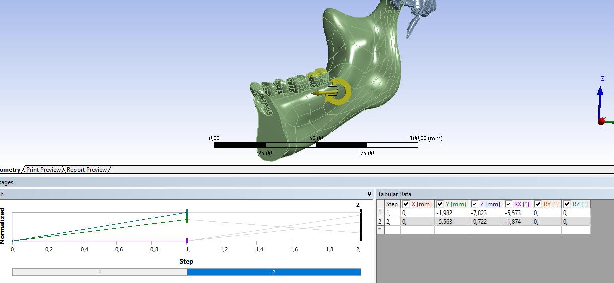

    this is the graph of the application of two remote displacements around different points
    Hi Peteroznewman, At the moment I can't post here any image so I will do my best to explain the situation.. I'm simulating the movement of a mandible when I apply these two rototranslations just to see how much is the movement of the mandible. I'm analyzing this movement on the sagittale plane that for me is YZ (Z is vertical, Y is backward) thus the two points have the X coordinate null and the rotation occurs around the X axis. The two remote displacements are scoped to the same face that is the teeth of the mandible. I don't know if it is correct to use two steps and I don't know how to link each other. I didn't deactivate the 2nd remote displacement during step 1 neither the first one during the 2nd displacment. I will try to do it tomorrow. So just to recap I have to insert 2 steps and during the firsy displacment when I set the tabular value for the displacements and the rotation I should start with 0,0,0 for coordinates and 0 for rotation then at step1 I insert the values for my first rototranslatoon and step 2 should be deactivated. Whilst regarding the second remote displacement I start always with 0,0,0 ,0 , then I deactivate step 1 and at step 2 I write the values of my second rototranslation? Exactly the values to be deactivated are the second rototranslation for my first remote displacement and the values of my first rototranslation for the second remote displacement? I hope to be clear.

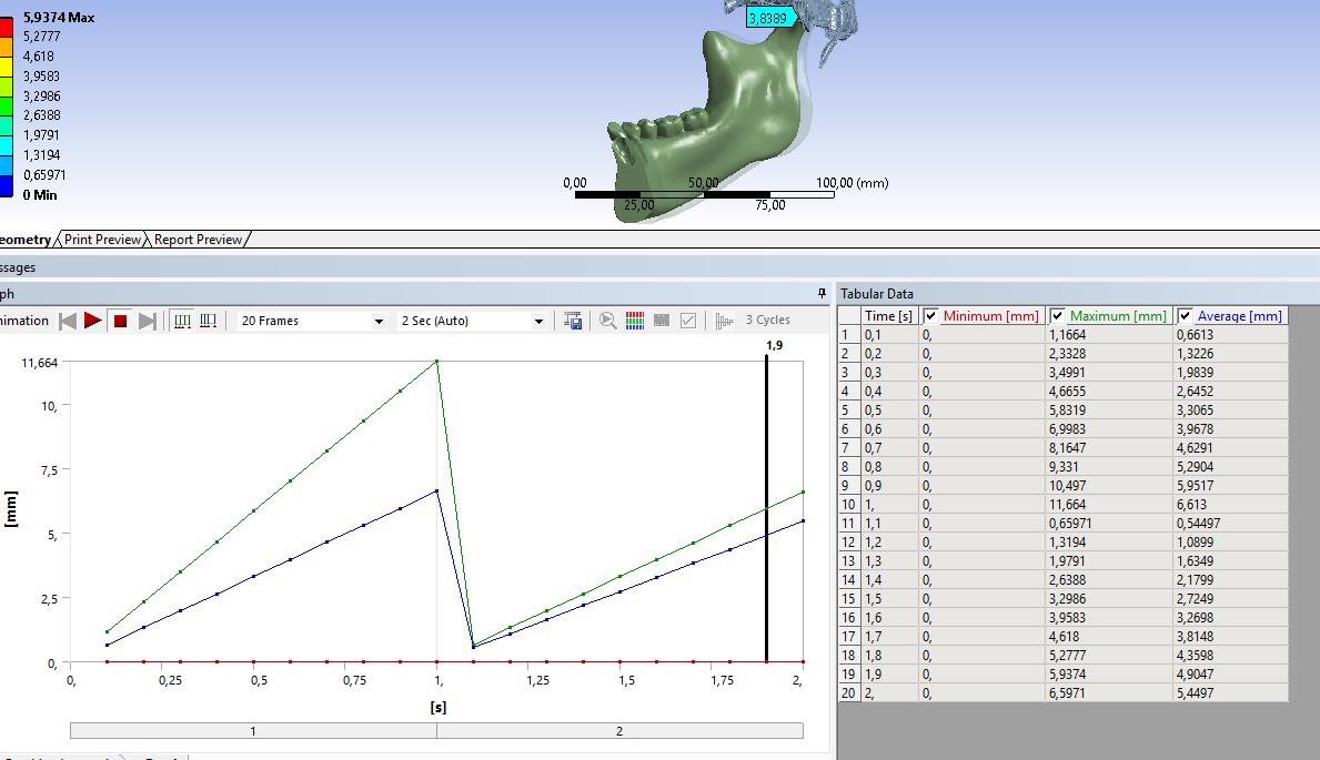

    I've attached the image of the graph so you can observe that the problem occurs at substep 1.1 since the displacement starts from 0,6 while I want that it continues followinf the first displacement. I want a sequential movement, not two separated movements...

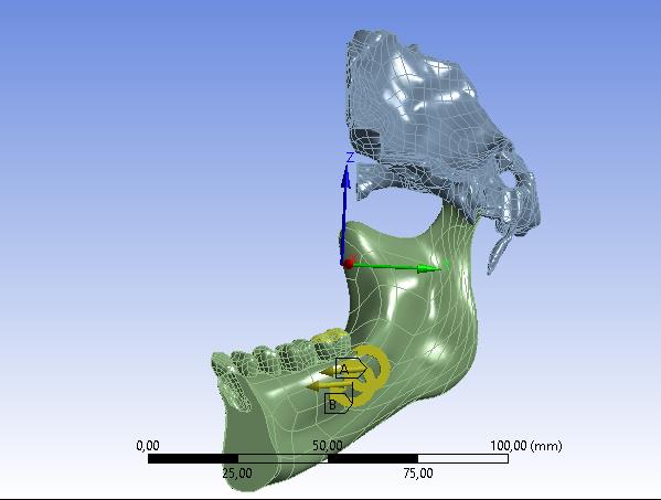

    Now that you have figured out how to insert an image, please reply with an image of the YZ plane so we can see the two points, labeled #1 and #2, and show the geometry they are attached to. Include information about the displacement of point #1 during step 1.  Obviously, point #2 moves during step 1, but you want to apply a displacement of point #2 from where it ended up after step #1. This can be done, I just want to try it out before I say how, to be sure it works.

    you can find attached all the images. As you can see I just want to get the secon displament starting form the end of the first one.
    thanks
    ..mandible in sagittal planefirst remote displacementsecond remote displacement (B point)total deformation

    the second point is indipendent from the first one.
    Please if you have any idea give me a tip or suggest another command to be used..

    -To conclude the tabular data near the graph of the total deformation show three columns minimum , maximum and average, what do they mean? is that the minimum, maximum and average displacement? if yes, according to which reference system have they been computed? because to define the two general joints I set two coordinate system over the vertices of the rectangle which are oriented according to the my global reference system.

    - Regarding the rototranslations I've specified in the connections the axes along which to move and the rotational axis, however as you can see from the picture it seems that only the first rototranslation occurs..
    For time step 1, you have some values for translation and rotation of joint 1 and joint 2 is set to zero.  For time step 2, the values of joint 1 remain constant (are the same as time step 1), while the values for joint 2 become non-zero in time step 2.
    They mean exactly what they are. If you have an edge or a body, then those three values will be different, but if you have a vertex, then those three values will be identical. For example, if you were to plot directional deformation of a body in the Y direction, and the top of the body moves -2 mm while the bottom of the body moves -8 mm then the maximum value would be -2 and the minimum value would be -8 and the average value would be between them.
