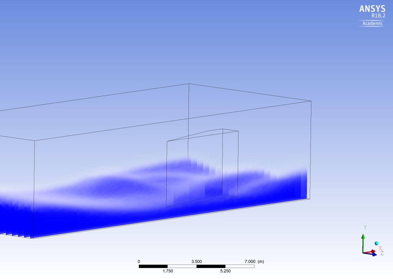

    I am sending you an image of that wave pool i am working with

    Why does it stop? Does it fail, or did it just run out of time steps?
  • Fabricio1Fabricio1 Member
    edited August 2019
    It says meshing folding problem

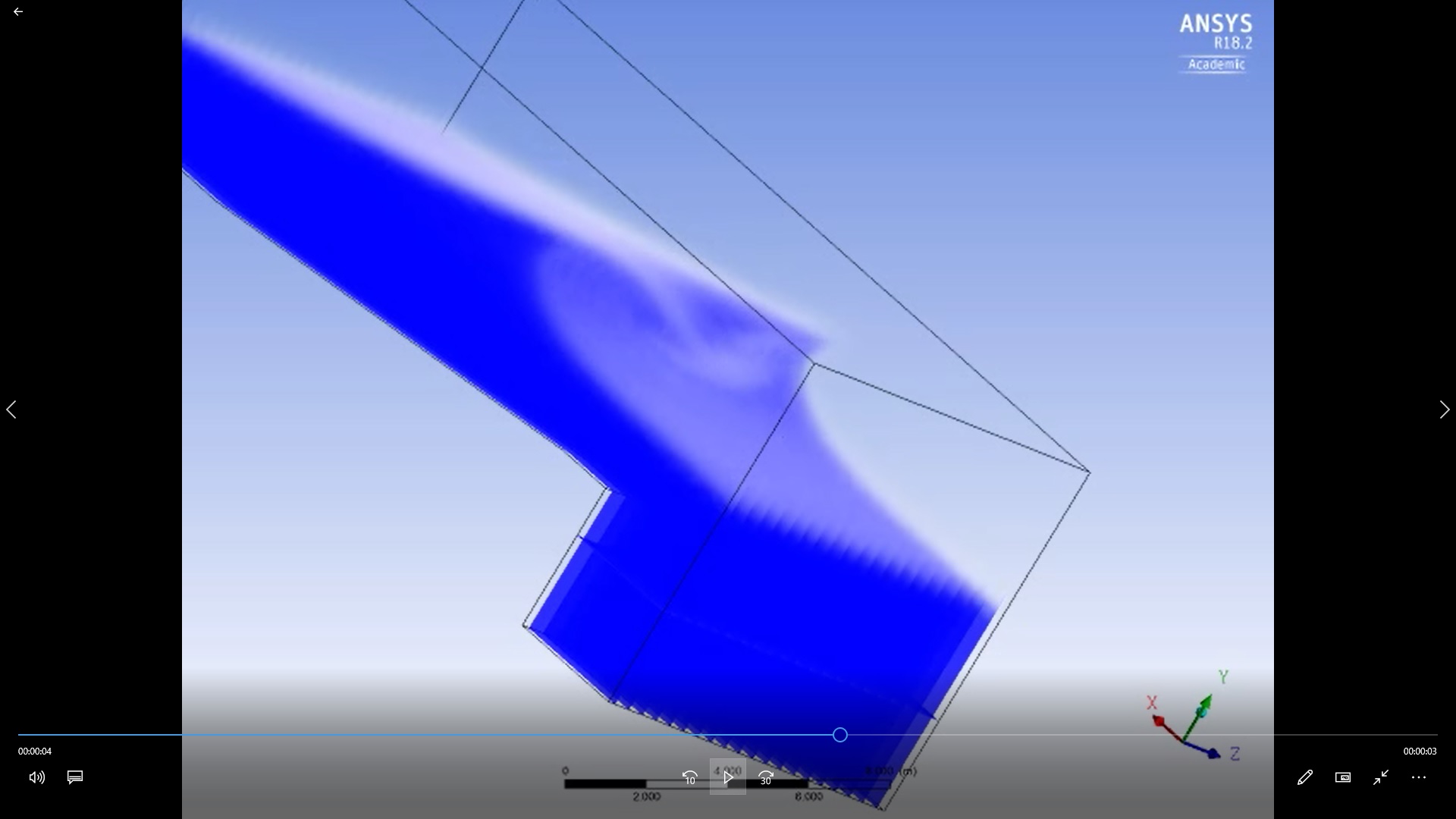

    I start with a time increment of 0.01sec and then reduce to 0.005 sec and the simulation goes a little further. However when I make the body stand still and accelerate the water towards the body I can use a 0.025 sec time increment without problems. See attached photo

    Which suggests that the moving mesh wants a smaller time step: what happens if you drop the time step by a factor of 10 as Peter suggests?
    edited August 2019
    I am trying a mixed approach by making the rigid body moves at 2m / s and making the water moves at 4m / s and using a time increment of 0.0001sec. In addition I activated the surface tension and increased the atmospheric pressure to 3 atm. Let's see how it goes;
    edited August 2019
    It seems that I have achieved a satisfactory solution by combining a 4m / s velocity of water flow with the movement of a solid using the displacement of its mesh with a sinusoidal function only in the -x direction. With that I was able to run several steps of time and generate an incipient wave that I will now refine.
