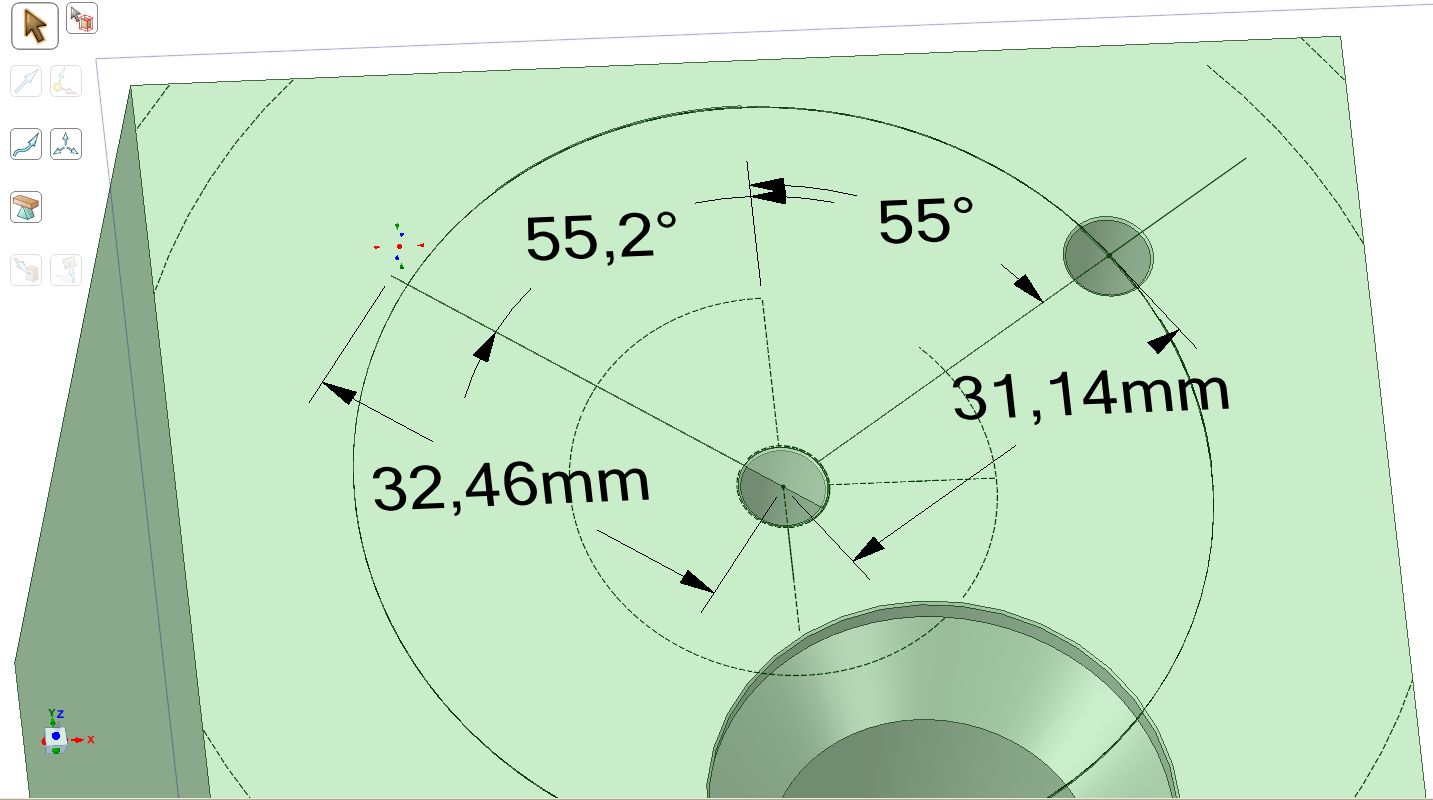

So I need to change certain dimensions I again I have a huge problem to change the dimensions. Basically I do not know how to do it at all, but have the changing dimensions with a star of the dimension, but it does not want to change it at all. Have a look at the SpaceClaim model 19.2 attached. And basically need to change e. g. dimension of the hole outwards into middle hole, which should be  32.5 mm e. g. and there is only 31.14 mm.

    So now it should be there! Thanks for have a look. And here you can also see some of the dimensions I need to implement into the model...

    But e. g. here you can see that you can change with the start the length, but it is not possible and the most important would be to understand the program. what it want to do in this case or how to find the possibility to change the length! Thanks for your opinion.
    edited August 2019
    I moved the hole face to 32 mm using the Move tool, exactly the way I showed in the silent video.  Then I dimensioned it in on the Details tab.

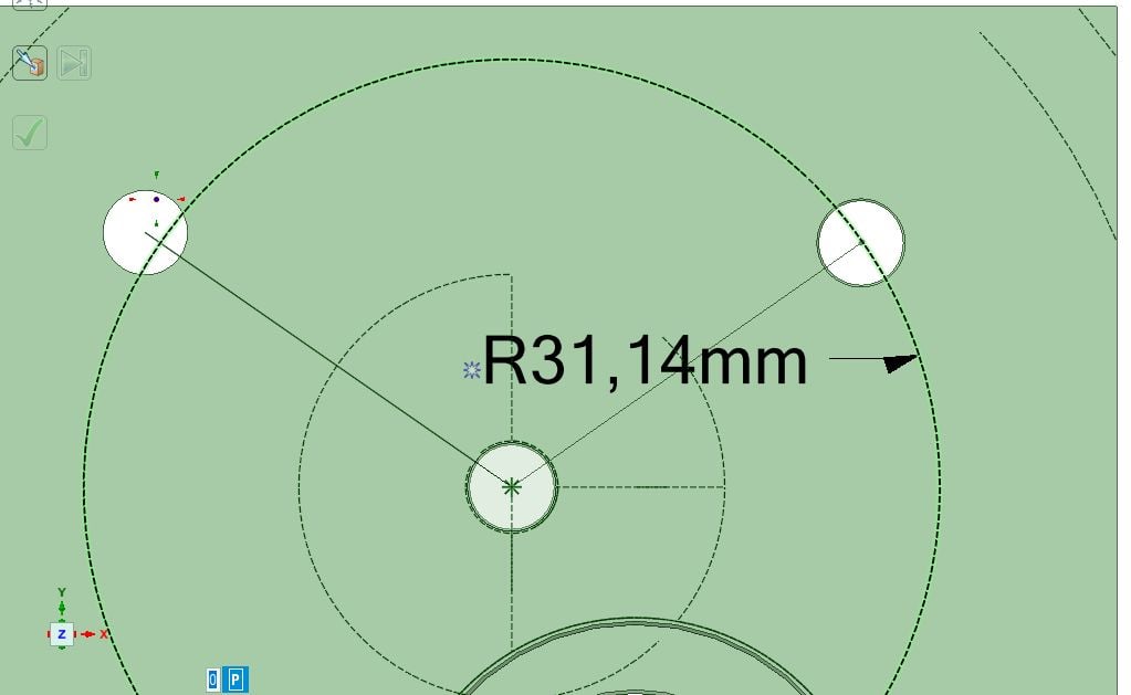

    You can see that the 31.14 dimension is to a sketch curve and not solid geometry.

    But obviously what is the most important to see is that I am not able to put there dimension - value. Strange problem, but the fact is that I am not able to change the plane from vertical to a different, that would be associated with the dimension plane!
  • Georgiro1Georgiro1 PragueMember
    edited August 2019
    So now there is a problem of changin the other hole to the distance of 31.2 mm and do not know again how to do this. Apart from the value that you see on the picture - it is a round, not the hole it has a small difference from 31.2 mm. So how this can be done. Thanks

    What do you need at the end?  A solid model or a dimensioned drawing?
    I don't dimension anything unless I need to make it variable geometry for parametric analysis.
    You drew a circle and it had a radius of 31.14 mm At the time you drew that circle, a box popped up with that dimension. That was your chance to type in 31.2
    If I accidentally lose the box with the dimension in it, I delete the curve and draw it again. I don't add a dimension to try to drive the dimension to a different value.
    Start over and type in 31.2 when the box is offered. Don't go forward with the wrong dimension.

    I did it as I need it so now it is fine so thanks for your help! My general problem is to be able to find if I see the stars to change the dimension that it is not basically be changed - you cannot change it normally, so the point is how to find out to be changing the dimension in general. This looks as the most problematic way! Thanks for your ideas!
    edited August 2019
    So e. g. I want to change the dimension of 31,14 to 31,2 mm and I have the stars to change the dimension, but it does not accept it at all. So would would you suggest to understand this problem and it is the most complicated problem at all.
    Thanks
    edited August 2019
    Some CAD systems keep a history of operations, so if you draw a sketch with a circle and radial line, then you make a hole in the solid at the intersection, the hole will move if you change the dimension of the circle.  SpaceClaim doesn't do that.
    You need the circle and radial line to make the hole, but after you have made the hole, hide the line and circle (the Curves folder) if you need it later.
    If you need a spark to move the hole, select the hole face (not the circle or point) and use the Move tool as shown in the silent video and when the box pops up to enter the dimension, click on the P and you will get a Group name with that dimension that can move the hole.

    So above I need to change the dimension of 31, 14 to 31,2 and angle 55,2° to 55°. So shall I create a new hole with different angle 55° or something else? Thanks
    edited August 2019
    Yes, delete the holes by selecting the four faces (chamfer and hole) and pressing the F key for Fill.
    Delete the circle and lines.
    Construct a circle at the correct diameter and two lines at 55 degrees.
    Create a hole at each intersection point to a diameter of your specification.

    Ok, I have deleted the hole, however I need to change the angle from 55,2° to 55°. But how to do it? I have again no idea how to do it! And as well as the length from 32,46 to 32,5 mm.
    edited August 2019
    Delete all the lines and circles.  Start a Sketch, and under Options, check the Create Layout Curves checkbox. Draw a line that is 32.5 mm long at an angle of 55 degrees, then go back to the Select tool.
    Start another sketch, but this time, without the Create Layout Curves option checked.  Draw a circle at the end of the line and type the diameter you need for the hole. Then go to 3D mode and use the Pull tool to make the hole.
