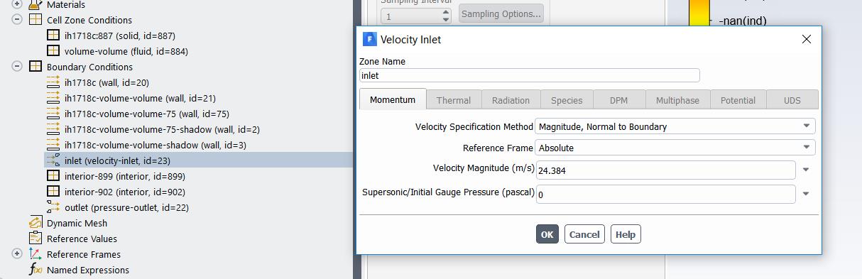

I am currently working on modeling flow through a butterfly valve when it is open/closed and at a few other angles. I have gotten the closed version to work and now I am trying to get the open version to work using the same model (Laminar flow, 1-inlet/1-outlet, same flow velocity, same solving methods). However, after multiple attempts I keep getting results that are inf (look at picture below titled 'contour prob'). My continuity is going off the charts so I assumed to change my mesh and make it a higher density, but to no avail. I have tried multiple meshing attempts all different so I am not sure if this is the problem anymore.
Could anyone provide insight onto what may be causing this? Like I said the closed version worked and now all I did was turn the valve to be open in SpaceClaim.
Below I will post a pic of the mesh as well, keep in mind this is just one of MANY meshes I have tried.

    Can you put a plane on the y-centre plane? Want to check you've got mesh in the right places.  What are the boundary condition? Also, what's the mesh quality?
  • mattsarg55mattsarg55 Member
    edited August 2019
    As far as boundary conditions go the only thing I have altered from the norm is the velocity at the inlet to be 24.384 m/s. Walls and interior are not altered, and the outlet pressure is at 0 pa so that we are operating at atmospheric pressure.

    That particulary mesh has a minimum orthogonal quality of 0.00.
    a maximum skewness of 1.728177
    124 skewed cells
    and a cell count of 242852
  • RobRob UKForum Coordinator
    edited August 2019
    That'll definitely not help convergence. Please review where the poor elements are and retry with a mesh that's not got flat elements in it.
