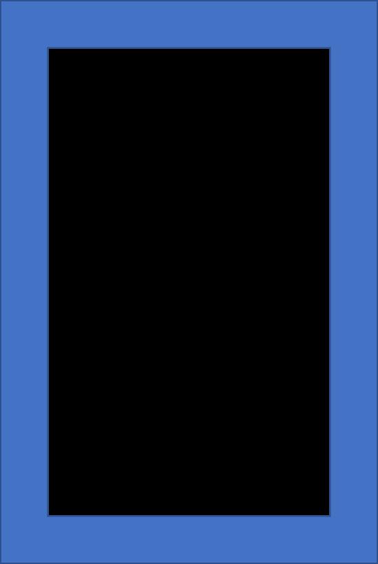

  • Aliosha86Aliosha86 Member
    edited September 2019
    Thank you, but unfortunately I am not able to use the skin depth mesh operation because it does not work for my geometry and I don't know why.
    I attach you the section of the geometry. I am selecting the surface and use the command but it does not work.
    Cheers,
