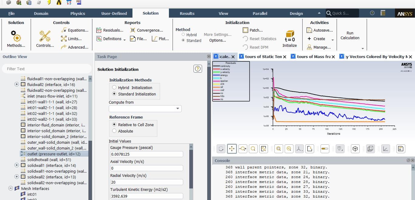

    The input summery is not an option for me in Fluent. Why can I not do this ?
  • RobRob UKForum Coordinator
    edited August 2019
    Click on the arrow on the "Run Calculation" button: you've resized the window and it's compressed the options.
