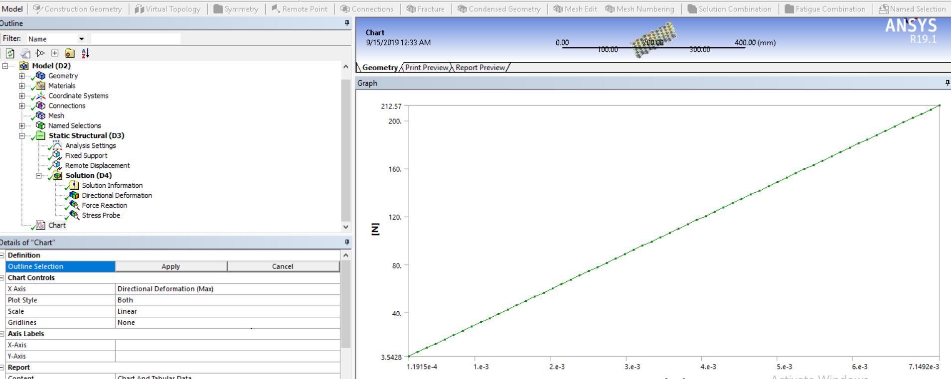

The force reaction in the lower face sheet at 1.25 sec is about 330 N. Dividing it by the surface area of the facesheet (50X105) will give the compressive strength of the whole sandwich panel=0.058 Mpa.
So why is the compressive strength of panel is less than core?
Is there any mistake in my meshing, constraints ,method or the values i used to define the honeycomb core under orthotropic materiel is wrong?

    Request a Reaction Force in the results. This perfect geometry will have the highest buckling force.  For a more realistic buckling force, you need to displace the perfect geometry by adding a small fraction of a modal shape.
    Note that you will need a fairly fine mesh to allow the model to create local buckling.  This is also very challenging to keep the solver converging all the way to the buckling point.
    Please reply with the Force-Displacement plot. You need to see the plot become horizontal and go into a negative slope to be able to say that the core failed by crushing.  You need to keep the Auto Time Stepping minimum number of substeps to a fairly high number to accomplish this. You also need plasticity in the Aluminum material model do allow this to happen.

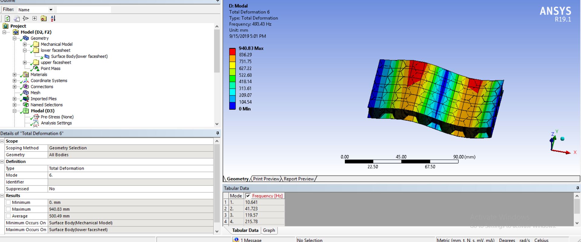

    i did find 6 mode shapes by point mass, cantilever method. And then i transferred the results of the modal to static structure for compressive testing. But the results doesn't change.
