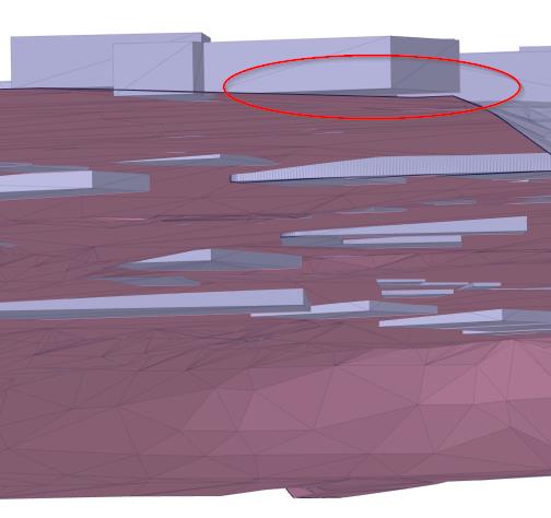

There are still many gaps between the buildings and the ground.

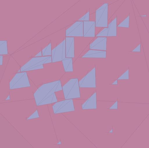

Any rectangular building that shows a triangular penetration has a gap.
Extrude the bottom of all the building far below ground so that no building has a gap.
The ground will be used to slice the building to the ground.

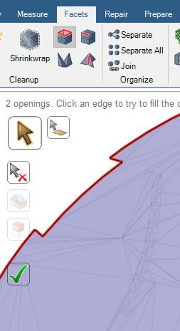

Filling the rectangular hole in the ground is easily done with this tool.
