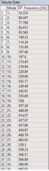

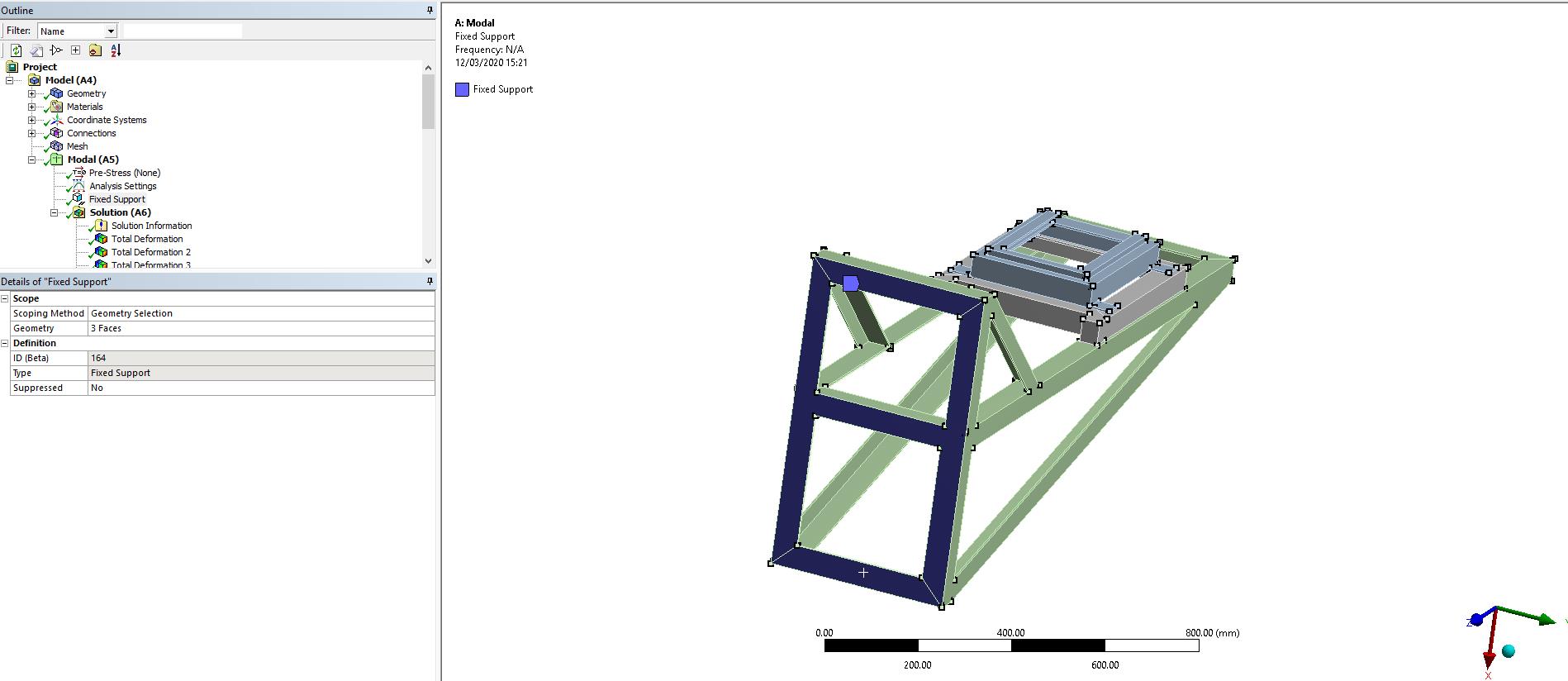

I have applied a fixed boundary condition to the bottom surfaces of the model, i thought this would be appropriate as the support is reasonably heavy and rests on the floor. There are now no zero values in the results but i am still receiving many clumped natural frequencies.
