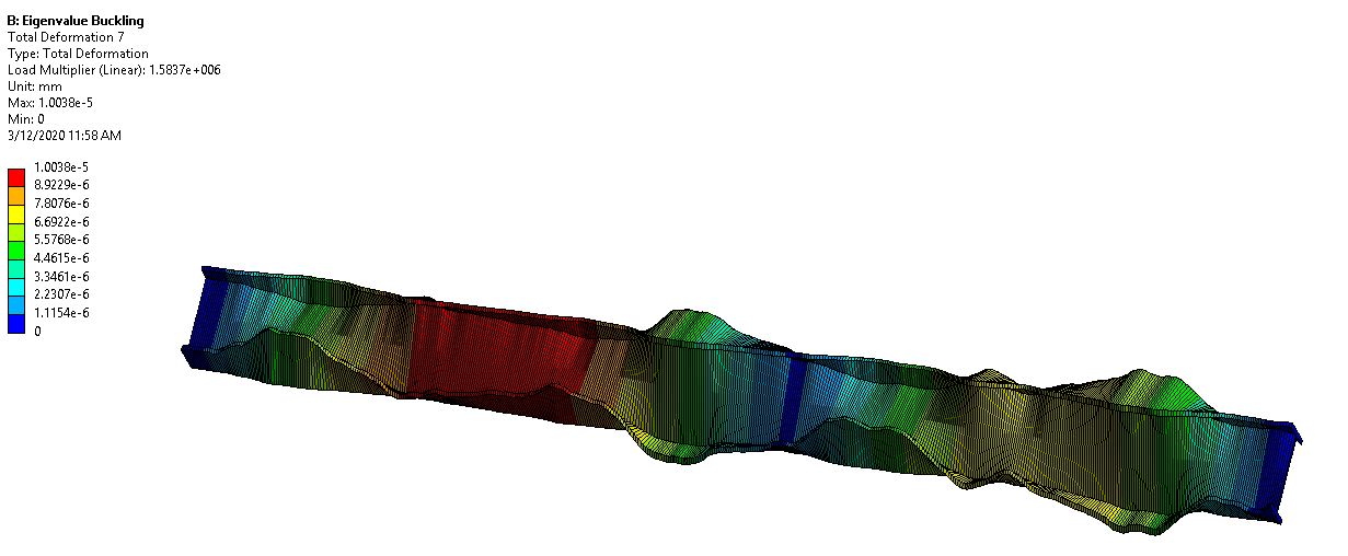

Hi Masri,
Thanks for replying. When I try higher natural frequency I see your behavior too (I apologize for not capturing it the first time, plus, my remote displacement location was wrong, it was not set to the end of the beam).
I think the reason could be the mesh size being too big and not able to capture the wavelength in high-frequency mode. Could you please try using a very refined mesh 5mm?
