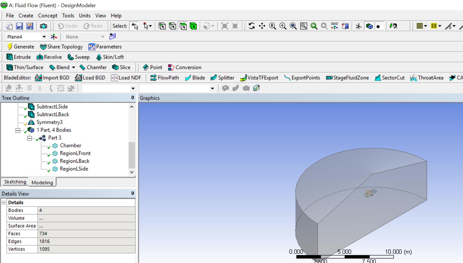

Here are the 4 bodies as a single part in DM:

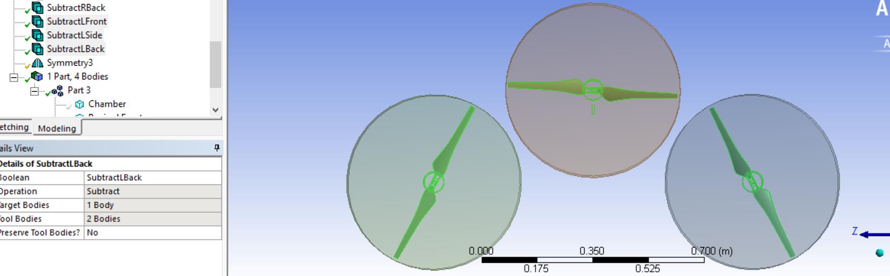

Here are the Boolean Subtract functions showing the parts that should be removed (3 rotors and 1 small rectangle):

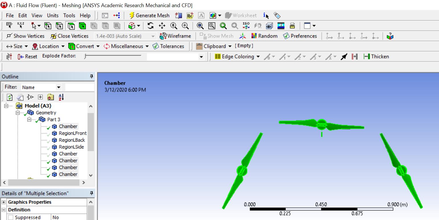

And here are the 8 bodies in Mesh.  I hid the bodies that should be in the model; these 4 highlighted bodies should be gone:
