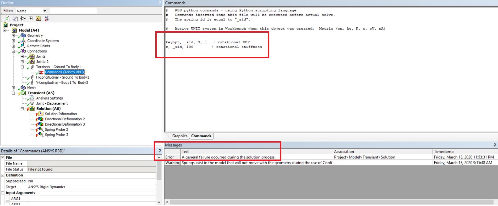

Thanks for the quick response to my query. Yes, I do want the inertial effect. So, as suggested I used RBD analysis, but with the command snippet to activate the rotational DOF of the longitudinal spring, error is occurring.
"A general failure occurred during the solution process."
Please suggest some solution.
